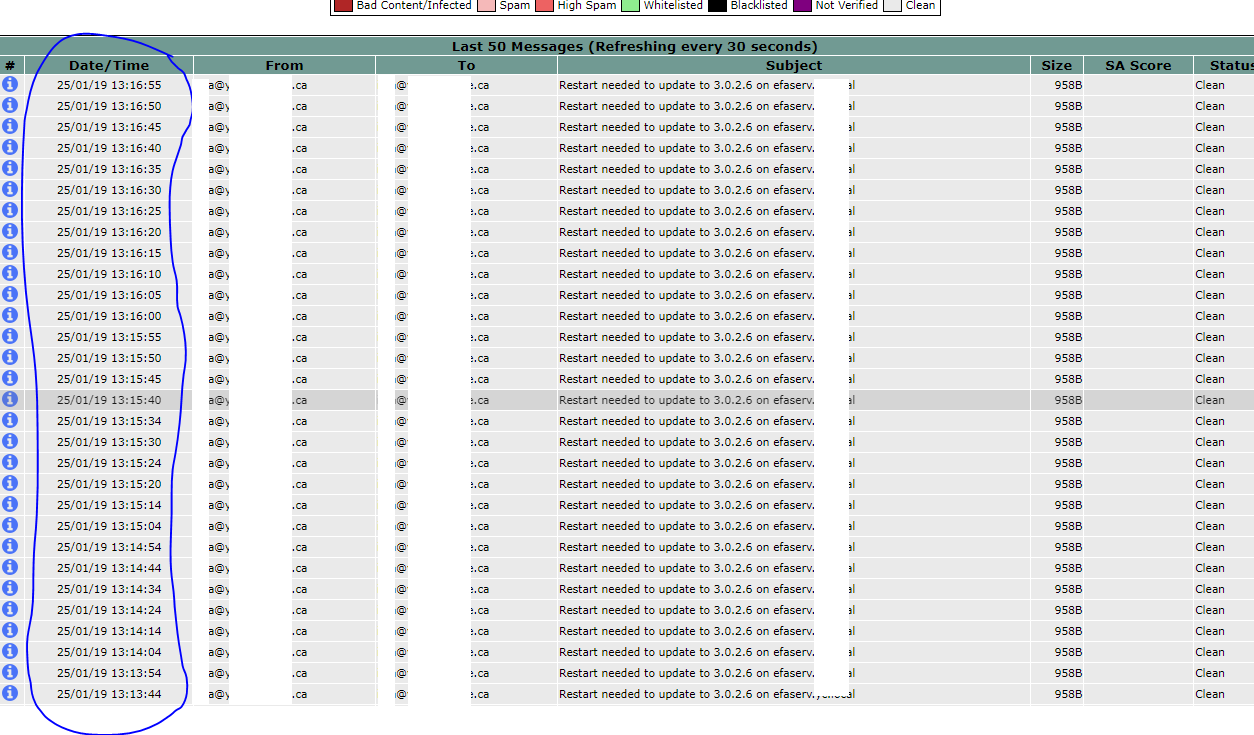

I've just finished setting up efa in hyperv to work with our exchange 2013 server and ran into something a little odd..
The automated system emails from root@mydomain got flagged by exchange sender ID filter (before I disabled it) so I tried releasing one of them, and what followed was a flood of that email sent from my email to my email, which never even made it to exchange.
There were about a 100 of those emails before I deleted the offending message from postfix queue. What happened? And is there a way to clean up the recent messages page?
- Capture.PNG (79.94 KiB) Viewed 11922 times

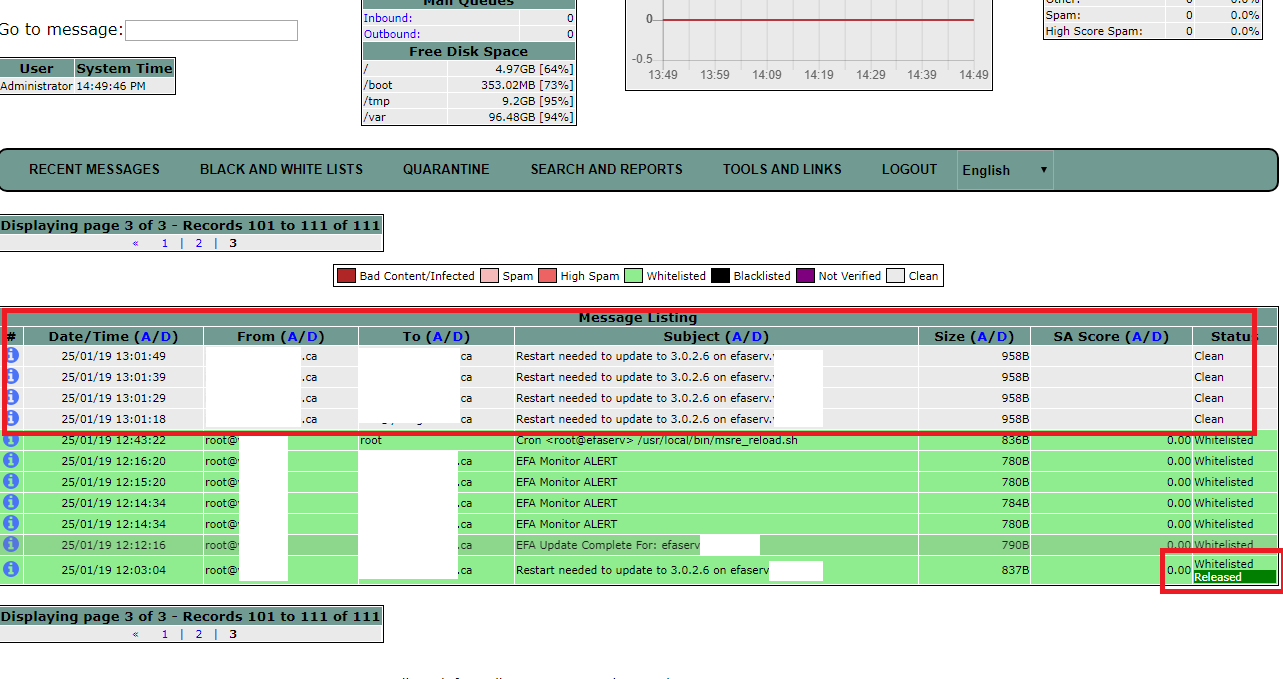

Hey Henk! Appreciate your reply. I didn't NEED to release white listed mail, I just tried it because the initial email got blocked by exchange and I wanted to resend it. Any idea why it wouldn't resend it but instead create a flood of those messages which never even reached exchange? (pic. attached)
Maillog doesn't contain anything with my email address or even root@efa. Aliases, EFA-Config and mailscanner/conf.php all include my personal email address and otherwise look good.
My only whitelist is this:
From: To:
127.0.0.1 default
Is this something I should change?
Thanks for your help!
- Capture.PNG (132.14 KiB) Viewed 11877 times

Henk, here's a screenshot of the message:
It's the same thing over and over again, as you can see by the long scroll bar
Thanks for all your help!

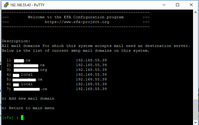

It appears to be sending and receiving 127.0.0.1, which is causing an endless loop
For some reason postfix is favoring your appliance over the final destination and delivering to itself.
Do you have a transport/relayhost defined for your domain and is it a hostname or ip?
If it is a hostname does the hostname resolve to the ip of your final destination?
Re: What happened after I released an email?
Appreciate you chiming in Shawn! That makes sense. I've uploaded my transport settings and I don't have an outbound relay (is that what you're talking about?) set-up.
Should I be adding localhost to transport settings too?
- transport.PNG (24 KiB) Viewed 11819 times

So I checked maillog again and somehow I missed this but there's countless log entries pertaining to the message loop:
Jan 25 13:01:29 efaserv MailScanner[9710]: Virus Scanning: Found 1 viruses
Jan 25 13:01:29 efaserv MailScanner[9710]: Spam Checks: Starting
Jan 25 13:01:29 efaserv MailScanner[9710]: Deleted 1 messages from processing-database
Jan 25 13:01:29 efaserv MailScanner[9710]: MailWatch: Logging message 252FC100061.A0789 to SQL
Jan 25 13:01:29 efaserv MailScanner[9710]: New Batch: Scanning 1 messages, 958 bytes
Jan 25 13:01:29 efaserv MailScanner[9710]: Virus and Content Scanning: Starting
Jan 25 13:01:29 efaserv MailScanner[9710]: Clamd::ERROR:: COULD NOT CONNECT TO CLAMD, RECOMMEND RESTARTING DAEMON :: .
Jan 25 13:01:29 efaserv MailScanner[9710]: Virus Scanning: Clamd found 1 infections
Jan 25 13:01:29 efaserv MailScanner[9710]: Virus Scanning: No virus scanners worked, so message batch was abandoned and retried!
There's a few posts on this forum about the same issue (I found a fix which I've yet to implement viewtopic.php?t=3128 ) and I'm wondering what's the deal? What are yara rules, why are they broken on a fresh hyperv install, and what are the drawbacks of disabling them?
