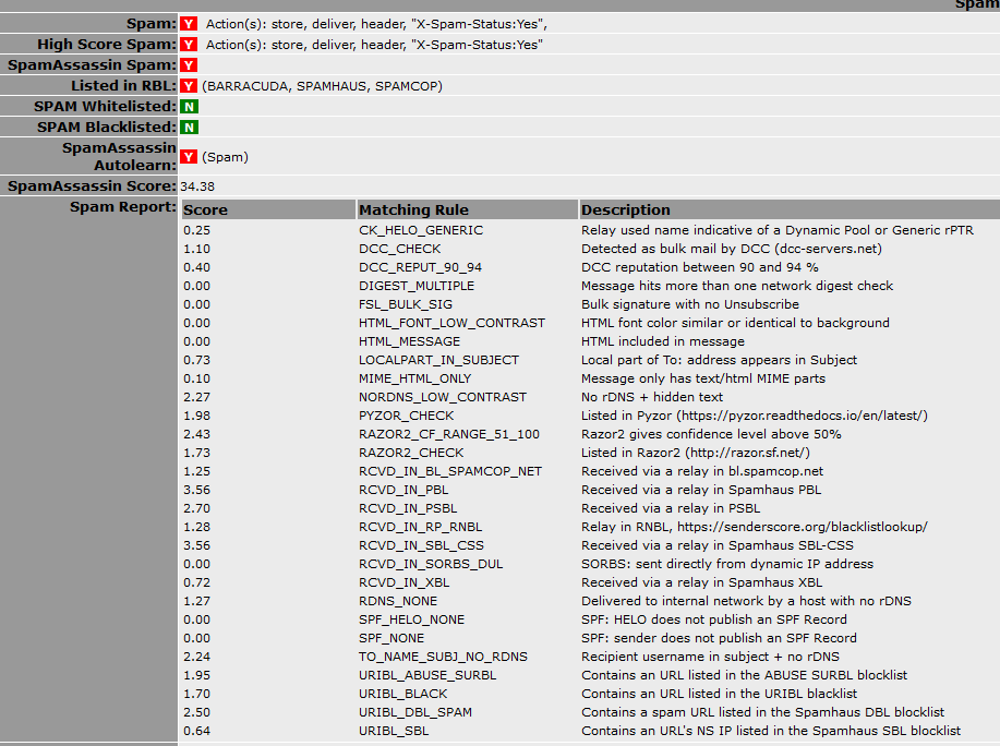

Now I have problem that bayes score is not displayed in mailwatch gui.
Bayes DB seems OK, SA lint test went trough OK, but bayes score is not displayed at all.
Any idea?
Re: Update to 4.0.2
gregecslo wrote: 09 Feb 2020 06:12 Hello.
I just removed mirrors from repo and it went OK.
Any idea?
Got a screenshot you could share?
gregecslo
Posts: 71
Joined: 09 Sep 2018 17:55
Re: Update to 4.0.2
Post by gregecslo »
Sure here.

Post by gregecslo »
Bayes is missing.
Also I have SPF_FAIL custom score set to add 5.0 points.
And in other case where I actually got mail with failed SPF it was scored + 0.95 points.
It`s like the prefs file was not evaluated or used at all.
