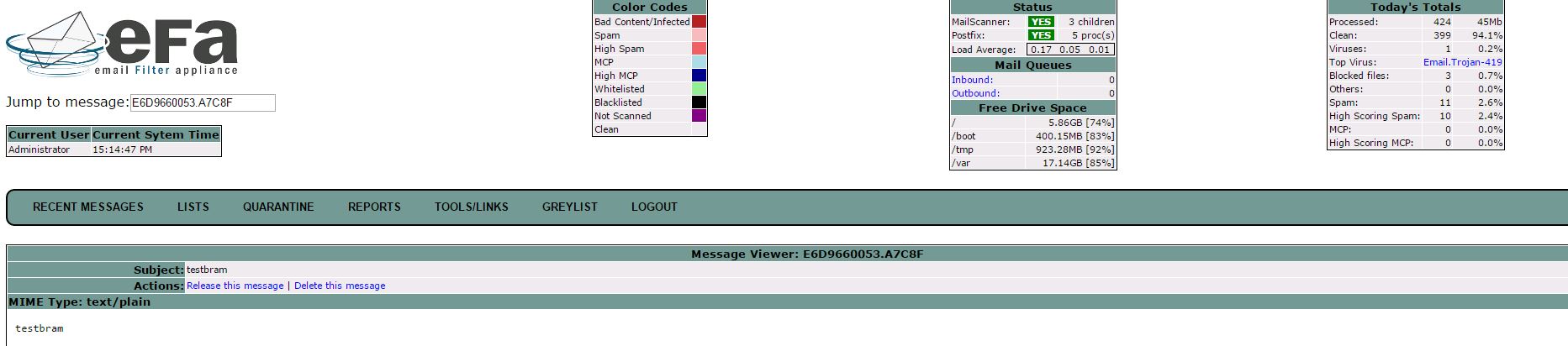

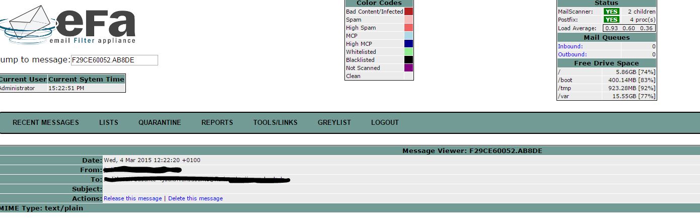

I've attached two screenshots:
(on another server) showing adresses
not working
not working
not showing adresses.
Working
Working
How can I solve this issue?
