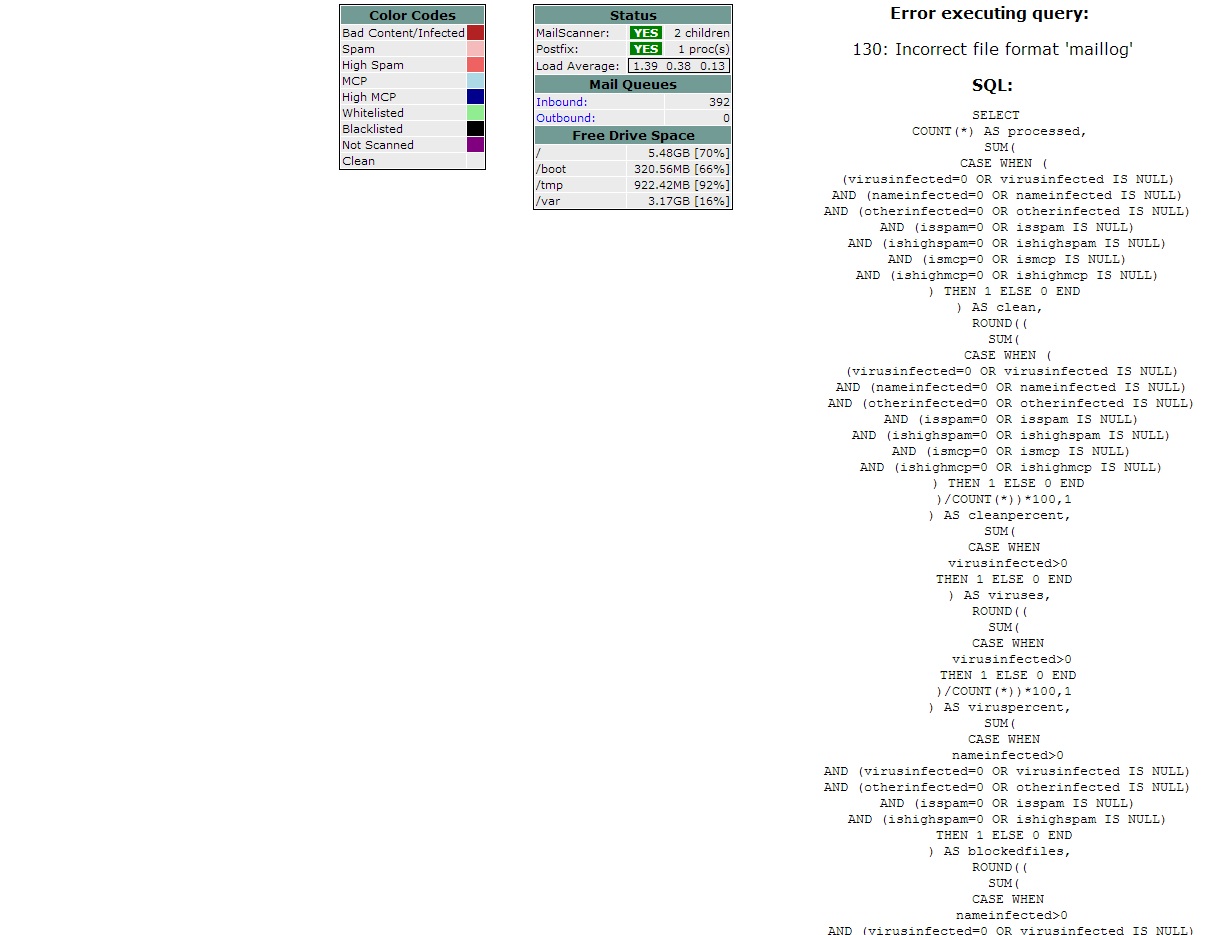

It would seem we had a power cut this morning and upon turning the mail-scanner back on, everything looked fine. I then noticed the queue was getting bigger and bigger so I clicked on it and didn't get what I was expecting. (Please see attachment)
I rebooted the machine, ran all updates and even a restore but all lead to the same result. I have temporarily moved all clients over to a backup system whilst we resolve this one.

Power Cut - Now Queue Problem
- Mailscanner issues.jpg (184.56 KiB) Viewed 4689 times

I see a few 'weird' items there.
Is your system using a whole lot of cpu power (100% all the time?) if so try to limit down the mailscanner childs, having to many is not a good practice ( I recommend max 1 child per CPU)
About the interface, I have seen that once during testing but never could re-produce it, so never found the reason why or how to fix this.
You do are on the latest version from E.F.A. ? (run EFA-Update from the console)
