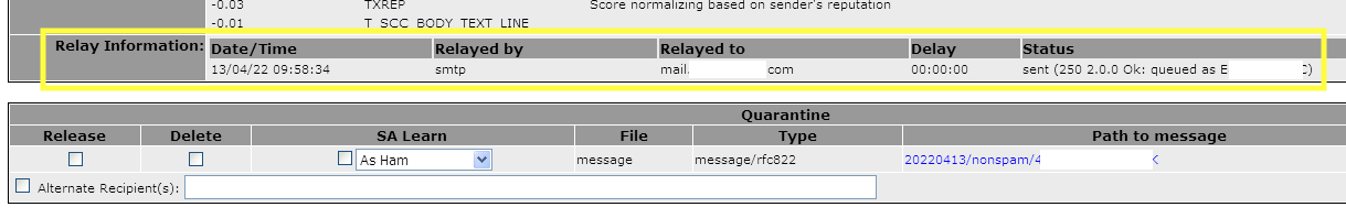

After updating eFa I am no longer seeing the Relay Information in the message details.
I have confirmed it went missing right when the update was done. Transport is working properly, it's just not capturing the delivery on the details page. Did it possibly get disabled? Any ideas?
I have rebooted the server and glanced through the config and logs but nothing jumps out.
