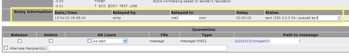

After updating eFa I am no longer seeing the Relay Information in the message details.
I have confirmed it went missing right when the update was done. Transport is working properly, it's just not capturing the delivery on the details page. Did it possibly get disabled? Any ideas?

The database table mtalog_id is NOT updating. I selected a message from the logs. Grabbed the smtpd_id and the smtp_id and manually inserted them into the mtalog_id table. The Relay Information now appears in the message details for that message. Watching the count on mta_log_id table confirms it is NOT updating. The mtalog table is populating properly. Now I just need to figure out what code/daemon should be updating the table.
I pulled a random message-id from the logs:
Apr 16 21:13:51 smtp postfix/cleanup[20077]: 4KgxWz0KjMzB48GB: message-id=<c1dd2922-be04@foo.com>
Apr 16 21:13:56 smtp postfix/cleanup[20077]: 4KgxX45MBhzB48GB: message-id=<c1dd2922-be04@foo.com>
I then inserted the smtpd_id and smtp_id into the mtalog_id table:
MariaDB [mailscanner]> INSERT INTO mtalog_ids (smtpd_id,smtp_id) VALUES ("4KgxWz0KjMzB48GB", "4KgxX45MBhzB48GB");
Query OK, 1 row affected (0.04 sec)
