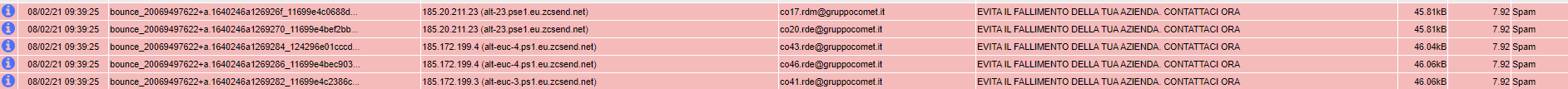

It happened that bayes record less messages than they arrived and are in range
for example i received 10 spamwith score in range and it recorded only 2
if i do a spamassassin -D < message it record the entry !
Is possible that is a priority issue so bayes look at message before it have the right score by other ruiles ?

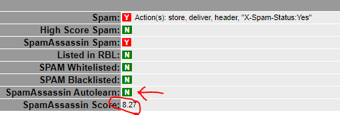

Posted: 09 Feb 2021 08:59
Nicola,
If you want to see at a glance if a message has been autolearned or not, you can make this quick change to /var/www/html/mailscanner/status.php
change
 salearn,
 '' AS status
FROM
 maillog
WHERE
to
 salearn,
 '' AS status
,case
when spamreport like '%autolearn=spam%' then 'spam'
when spamreport like '%autolearn=not spam%' then 'not spam'
else '-'
end as 'Auto Learn'
FROM
 maillog
WHERE
and then you'll see which messages have been autolearned.
See here for more details: viewtopic.php?t=2642

and here is the results from one that wasn't, even though it was seen as spam by spamassassin.
Feb 9 17:04:43.697 [6969] dbg: plugin: Mail::SpamAssassin::Plugin::AutoLearnThreshold=HASH(0x3d51cc8) implements 'autolearn_discriminator', priority 0
Feb 9 17:04:43.697 [6969] dbg: learn: auto-learn? ham=0.1, spam=6, body-points=1.701, head-points=10.286, learned-points=6
Feb 9 17:04:43.698 [6969] dbg: learn: auto-learn: autolearn_force not flagged for a rule. Body Only Points: 1.701 (3 req'd) / Head Only Points: 10.286 (3 req'd)
Feb 9 17:04:43.698 [6969] dbg: learn: auto-learn? no: scored as spam but too few body points (1.701 < 3)
