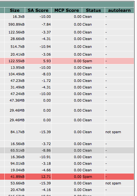

Re: spamassassin autolearn always no
pdwalker wrote: 01 Sep 2017 04:46Now that I think about it, I wonder if there is a way to report whether a particular message has been "learned" or not by spamassassin?
I didn't need to do this, but I felt compelled to answer my own question anyway.
If you edit /var/www/html/mailscanner/status.php and find the sql query at the beginning of the file, insert the following lines just before the "FROM" line:
,case
when spamreport like '%autolearn=spam%' then 'spam'
when spamreport like '%autolearn=not spam%' then 'not spam'
else '-'
so
 mcpsascore,
 '' AS status
FROM
 maillog
becomes:
 mcpsascore,
 '' AS status
,case
  else '-'
end as autolearn
FROM
 maillog
and you'll end up with an extra column on the far right that'll answer your question whether a message has been autolearned or not, and if so, as what. (not a multiple display language friendly fix, I was in a hurry)
Note to self: Make the modifications necessary to also display whether it has been "learned" by the bayes classifier or not, in the same column.
Note to self: but don't do this today no matter how much you want to.
