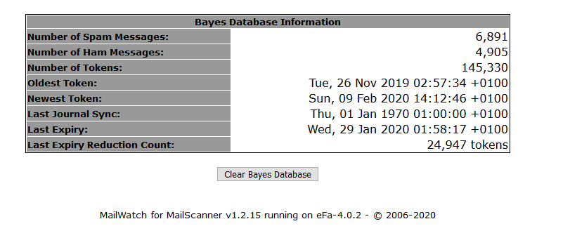

Re: Update to 4.0.2
Posted: 09 Feb 2020 13:17
by gregecslo
Bayes is missing.
Also I have SPF_FAIL custom score set to add 5.0 points.
And in other case where I actually got mail with failed SPF it was scored + 0.95 points.
It`s like the prefs file was not evaluated or used at all.
Lint tests:
Also byes DB seems quite OK:
- efa403.PNG (18.09 KiB) Viewed 29429 times
I really don`t know what went wrong here
