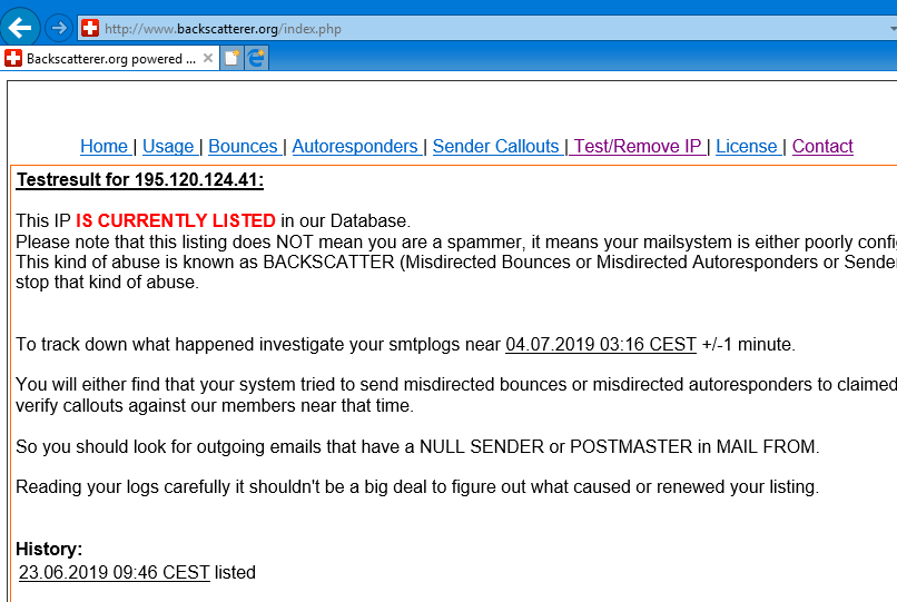

My mailserver ip is blacklisted by this site,
They ask me money for immediate delisting and there is no way to contact them
I have efa configured to accept our domain only and it check in ldap for recipent at smtp level
when is not present it give reject immediately and have no bounces
I watch log at time they specified and there is no messages outgoing
what do you think about this site ?
