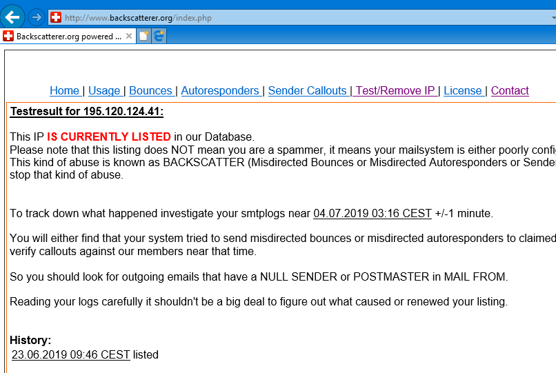

My mailserver ip is blacklisted by this site,
They ask me money for immediate delisting and there is no way to contact them
I have efa configured to accept our domain only and it check in ldap for recipent at smtp level
when is not present it give reject immediately and have no bounces
I watch log at time they specified and there is no messages outgoing
what do you think about this site ?

I found problem
efa query ldap and reject at conversation level so is impossible that it accept for other domains
impossible ? yes but ldap query returns also AD contacts recipients !!!
So if you have some contacts defined in ad that have other domains ldap query consider it valid
and it they bounces is a backscatter
so is not a good thing
I think that is needed a directive in ldap_relay_recipient_maps.cf to filter contacts
or can be done adding domain to this filter
query_filter = (|(proxyAddresses=smtp:%s) (proxyAddresses=SMTP:%s))
