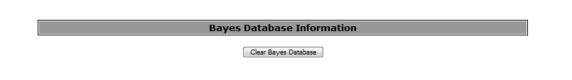

issue 2
The bayes database is restored, but no access via the Gui.
2019 Bayes Database Info.png (2.26 KiB) Viewed 30614 times
Not clear why.
Only Import bayes works fine:
On v3 :
backup bayes
sa-learn --backup > backup.txt
On v4
Clear and restore bayes backup
sa-learn --clear
sa-learn --restore backup.txt

Migration, second try.
I reverted EFA4 to the situation before the yum update. ( after the kickstart build and eFa configure)
1. yum check-update and a yum update
2. reboot
3. Copy the EFA backup and the bayes backup to efa 4
4. Restore EFA backup ( Option 12)
- After the restore backup bayes data is not visible via the gui.
5. Clear bayes database via the Gui ( TOOLS AND LINKS-> SpamAssassin Bayes Database Info-> Clear Bayes Database)
6. Restore bayes ( sa-learn --restore backup.txt)
7 . Login and watch the miracle of your new Efa 4 with all the data from Efa3, without any error :clap: :dance: :violin:
