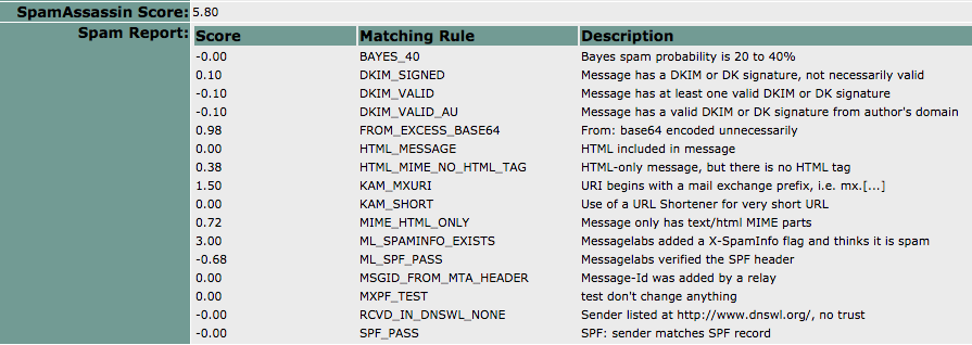

2/ In order to work out why a message has been flagged as spam, you'll need to look at the spam report in the message details.
For example, this message is "maybe spam":
Screen Shot 2018-09-26 at 16.11.10.png (98.89 KiB) Viewed 15627 times
If I decided this message was spam/not spam, then I would flag it in spamassassin so the bayes filter would be updated (right now it shows at 20-40% which is neutral.
In this example, none of the other rules are worth me changing. (ignore the 3.0 score - that's a bonus added when another spam detection thinks the message is spam)
As you look at the scores - you can then decide what is normal, or not normal - and perhaps customize your scores appropriately. For example, I really boost the spam score when bayes says it is 99% likely spam.
Could you post a screenshot of the spam score for a message you think shouldn't be spam? Perhaps one of us may have further suggestions.

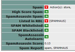

A lot of newsletter type stuff and community/forum emails seem to get stopped by Spamhaus (spamcop did the same), but if I lookup the IPs within a short period of time they show as not blocked, they are not on the list.
The below screenshot is for an email I should have had from another forum, which came in to me about 5 minutes ago, got stopped and is not showing as on the Spamhaus lists
Efa Spamhaus.JPG (26.1 KiB) Viewed 15588 times
Efa IP.JPG (21.77 KiB) Viewed 15588 times
Emails from MailChimp also tend to be stopped for the same reason and while I can release them and learn them as ham - they are already not hitting the spam score, they get stopped by and RBL filter.
Given they are not stopped for being spam, I am doubtful marking them as ham is doing anything to help.
