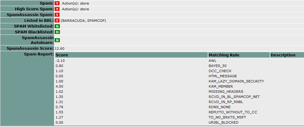

Here is a set of headers from an email:
This particular one got stopped (looking at the subject I am happy it is rubbish)
I will get my colleague to select a suitable email to show the headers / Spam report.
Cheers
ElFranko

X-MimeOLE: Produced By Microsoft MimeOLE V15.4.3538.513I will get my colleague to select a suitable email to show the headers / Spam report.
Cheers
ElFranko
- spamreport.JPG (57.17 KiB) Viewed 15532 times

Your current example really looks like spam. Are you sure it is not spam?

Is the above example an example of a message you think should be considered non-spam?
