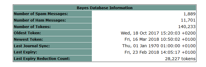

About traing bayes. Check in the Gui : Tools and links-
> Spamassasin Bayes database info
SpamAssassin Bayes Database Info.png (10.97 KiB) Viewed 30068 times
>Spamassassin Lint (test)
Find the next entry: dbg: bayes: corpus size: nspam = 1889, nham = 11701 .This should match the bayes db info of course
Bayes need at least 200 ham and spam to operate.
In the message detail you can train bayes. Since autolearn is : Y for this message a token is already added ( it will add a token only once. )
Message Detail.png (37.09 KiB) Viewed 30068 times
So take some time to classify mail. It worth the effort.

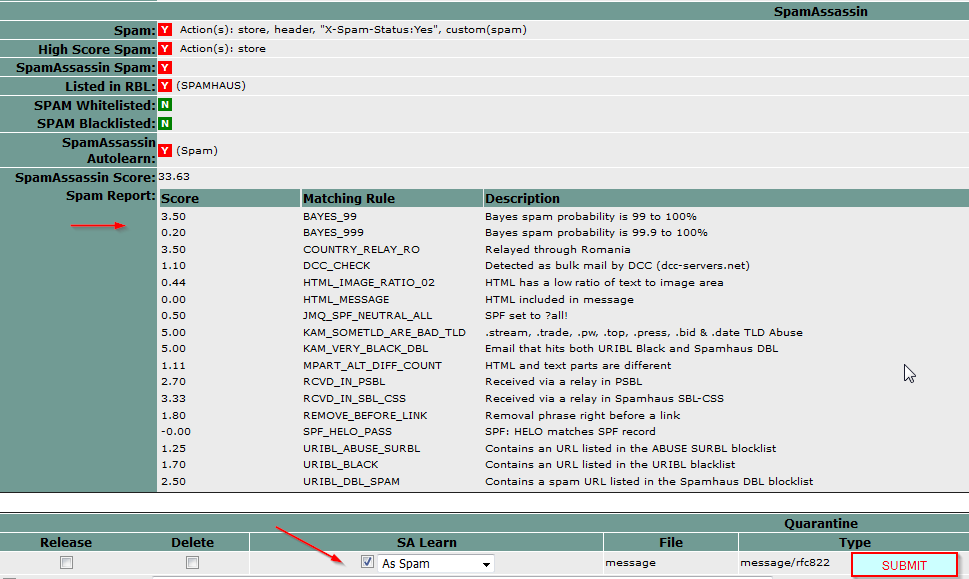

Can you show us the spam report for a message that was not detected as spam?

yellow is not spam
Re: SPAM Problem
Posted: 23 Mar 2018 17:12
by telvenes
spam report

Before jumping to conclusions, since bayes looks fine and valid mail is valid mail ;)
Just post the complete message details on spam slipping thru ( and hide the personal info)

Hmmm. Those are really low spam scores.
The first thing I notice is the bayes_50. That means the Bayesian analysis doesn’t see it as spam yet, so it’ll need more training on these messages. Also, you should tell the analyzer which messages are “ham” which will help the analyzer distinguish the two.
Greylisting should definitely be left on as it stops a fair amount of spam from coming in in the first place.
Also, is your system properly configured to use the real time dns block lists correctly? I guess not and this may be contributing to your low spam scores.
Would you be willing to send me one of those spam messsages so I could test it against my installation so I could compare the results?
