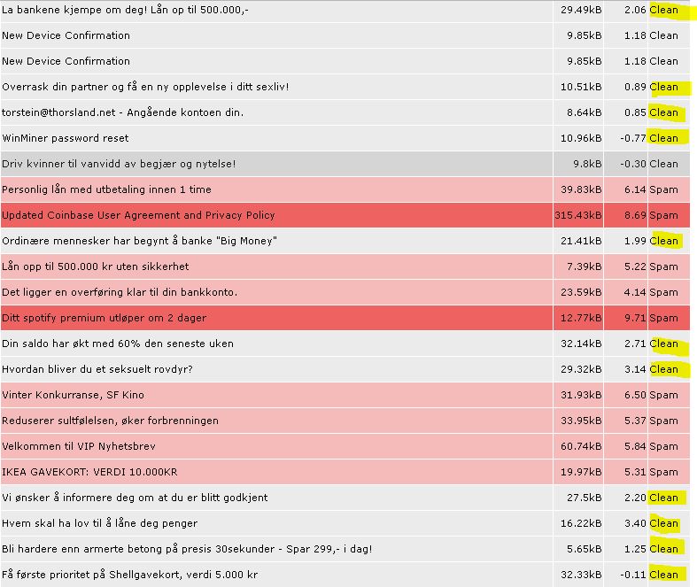

I use EFA Project for only 20 domains, but i get way 2 much spam. Can anyone help me to adjust it to be bether?
Re: SPAM Problem
Marked with yellow is spam
- Skjermbilde.JPG (110.6 KiB) Viewed 29373 times

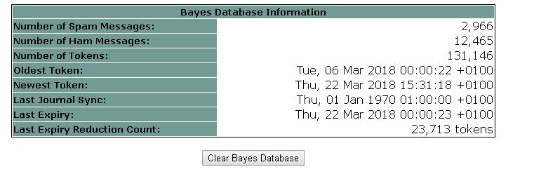

About traing bayes. Check in the Gui : Tools and links-
> Spamassasin Bayes database info >Spamassassin Lint (test)
Find the next entry: dbg: bayes: corpus size: nspam = 1889, nham = 11701 .This should match the bayes db info of course
Bayes need at least 200 ham and spam to operate.
In the message detail you can train bayes. Since autolearn is : Y for this message a token is already added ( it will add a token only once. ) So take some time to classify mail. It worth the effort.

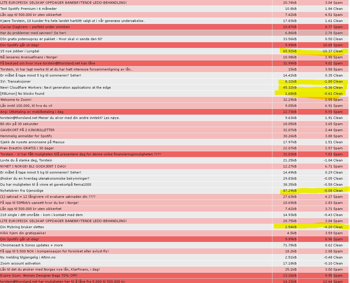

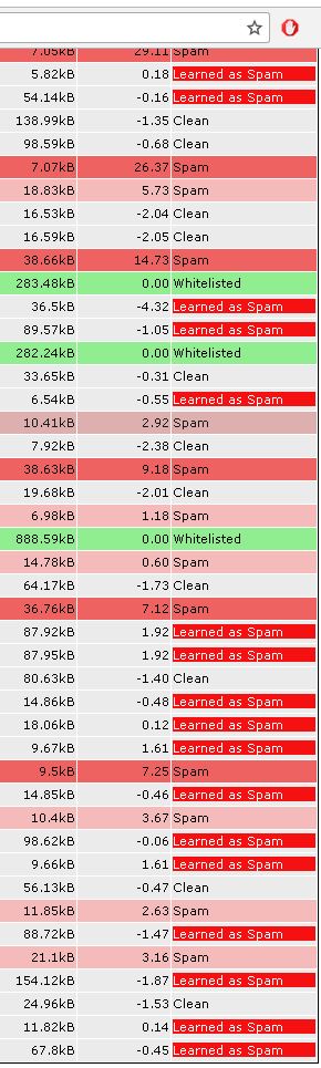

I have changed score to 2 to kill. it helps now but i still get lots of spam.. this is my byes
I have tried to report as spam for many days without help
- Skjermbilde.JPG (45.52 KiB) Viewed 29276 times

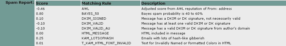

Re: SPAM Problem
Hmmm. Those are really low spam scores.
The first thing I notice is the bayes_50. That means the Bayesian analysis doesn’t see it as spam yet, so it’ll need more training on these messages. Also, you should tell the analyzer which messages are “ham” which will help the analyzer distinguish the two.
Greylisting should definitely be left on as it stops a fair amount of spam from coming in in the first place.
Also, is your system properly configured to use the real time dns block lists correctly? I guess not and this may be contributing to your low spam scores.
