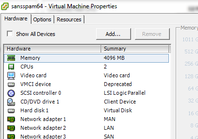

Just to be sure (and to exclude) it has absolutely nothing to do with the hardware, is it possible to vmotion the server to another host with other disks (or maybe to the local disks of another host)
Re: mysql overloading system cpu/IO
Posted: 04 Feb 2018 06:58
by jheffez
As I mentioned:
1. I have an Exchange VM server running on that ESX and it's working just fine.
2. The EFA has been working fine for the first two months.
It is not the hardware nor the underline ESXi.

Have you moved the server to be sure?
I have seen more problems solved by just moving a server to another host, while other servers on that same host did not have any issue, and there was also nothing found in the log or monitoring.
Just give it a try.......
Btw. also check your snapshots, maybe there is an old one you did not noticed.

What is your current memory:885080k ????
- spamProperties.png (17.86 KiB) Viewed 131082 times

The VM memory size is now 1.1GB
Below is a "top" snapshot (quiet time, not when mysql queries are timing out):

Yes, your memory report looks wrong.
Type this command at the efa command prompt: free
[root@efa mysql]# free
total used free shared buffers cached
Mem: 8061012 6046144 2014868 884 270716 3441012
-/+ buffers/cache: 2334416 5726596
Swap: 0 0 0

Here you go:
free
Mem: 1059156 956620 102536 72 6920 121796
-/+ buffers/cache: 827904 231252
Swap: 4194300 762840 3431460
Posted: 06 Feb 2018 08:24
Set your memory to 4096 MB and see what happens
Posted: 06 Feb 2018 11:07
No bloody wonder it's slow!
Set it to 8GB, or leave it at 4GB and turn off all the extra services.
