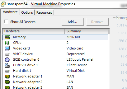

Re: mysql overloading system cpu/IO
Set your memory to 4096 MB and see what happens :roll:
No bloody wonder it's slow!
Set it to 8GB, or leave it at 4GB and turn off all the extra services.
