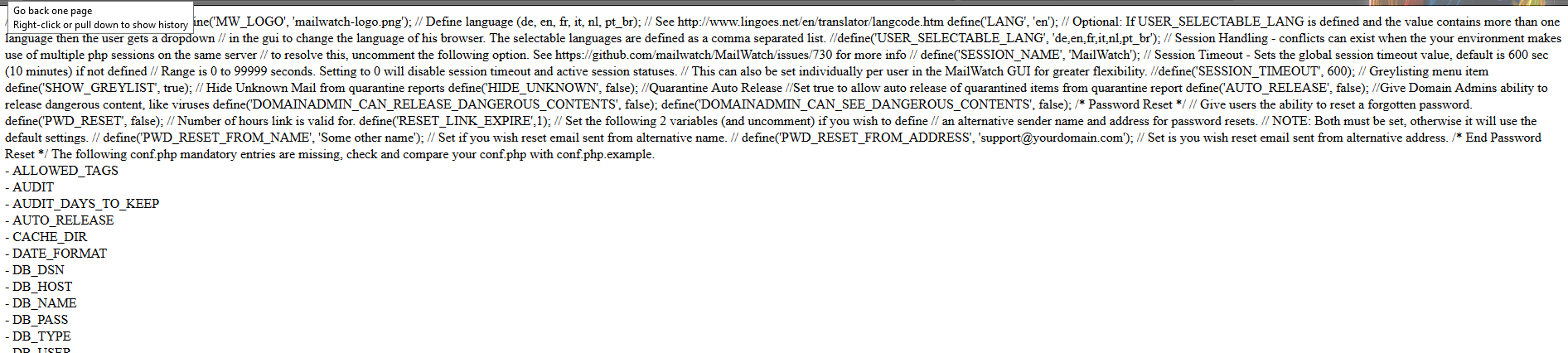

After installing the web page doesn't work 404 /mailscanner/, after upgrading to current version the page loads but only with text (screenshot).
