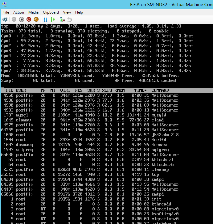

by toddh
Is the VM running out of Memory and swapping - I don't think so. I started with 2 Gb Ram and have been slowly incrementing by 2GB so now I am up to 8 Gb. So far whatever I give it seems to use. However when the slowness occurred several days ago I bumped ram from 6 to 8 Gb and it made no difference. Adding cores at the time did.
Top processes rotate but mostly MailScanner, Clam, ImageCerbius, and MySQL. I would like to move the MySQL DBs to a dedicated MySQL server we have and offload some resources.
Top after its been running about 35 hrs
EFA1 Top.PNG (51.83 KiB) Viewed 41538 times
I am seeing wa times from .0 - 12.% at the moment, which is a slower time right now - 5 pm and everyone is leaving for the day. I will look at my disks and see where this VM is running. Its on a cluster so I have to trace the CSV to the SAN and Disk Volume.

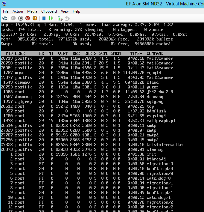

by toddh
VM is vhd from EFA.
Morning business is starting here so this is normal/light load
EFA1 Top1A.PNG (71.68 KiB) Viewed 41528 times
Host machine has nothing else significant running. Dell c6100, 2x Xeon L5520( 16 Cores ) 48 Gb ram. The SAN and disk array that the VM sits on runs a number of other VMs so the storage is not idea for this type of load. I enabled LSI Cachecade on the CSV last night to see if that helps.

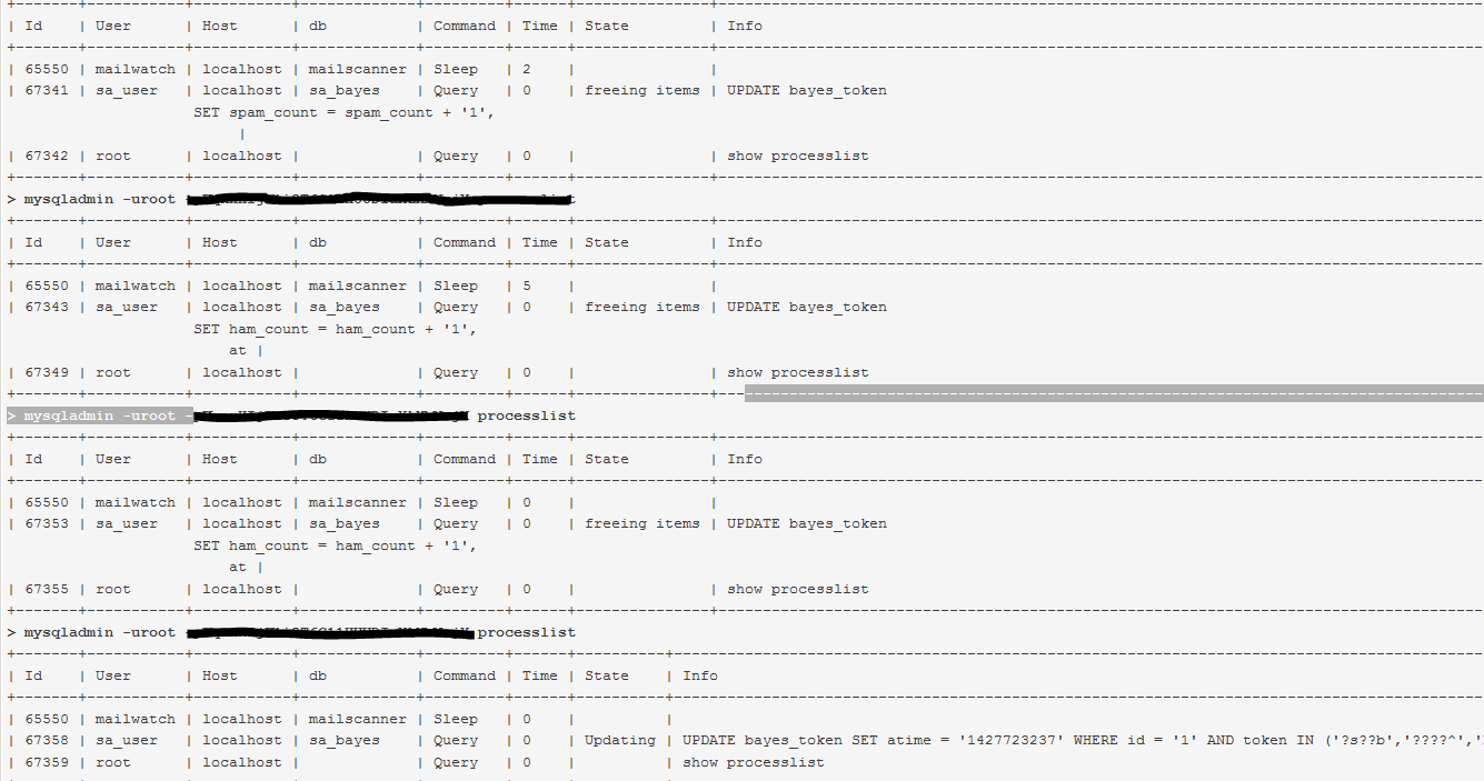

Posted: 27 Mar 2015 19:01
Can you run the following command a couple of times and tell me what kind of queries to which database you are seeing?
mysqladmin -uroot -p<EFA mysql root password from /etc/EFA-Config> processlist
run it 5 or 10 times. what ones in the "db" column show active queries? ("Command" column = "Query")

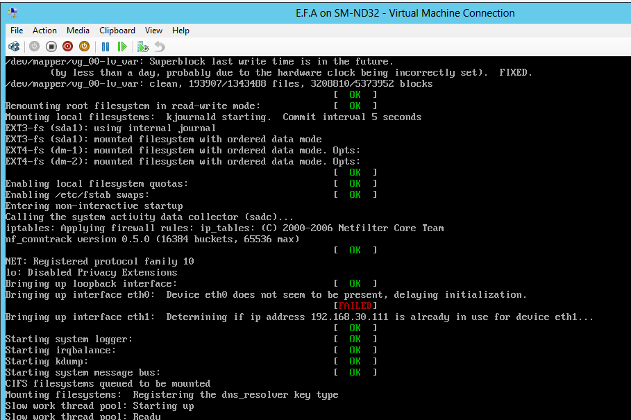

Went to look for the pw in /etc/EFA-Conf and found
INTERFACE:eth0
But I am using eth1.
I get this error when booting. Could this be related
EFA eth0 error.PNG (50.05 KiB) Viewed 41513 times
I believe this happened after I moved or copied the VM, not sure which. I simply assigned IP info to eth1 when it happened and everything was working so I left it.

by toddh
MySQL query. Ran it a number of times, most responses were like the last 2.

Re: Improving my EFA Performance
Posted: 30 Mar 2015 14:15
by toddh
When I run the command a number of times quickly i get the f0llowig. Not much change in Top. Load was around 2.17, 1.79, 1.58, not a large variance.
EFA MySQL Query1.PNG (41.23 KiB) Viewed 41485 times
