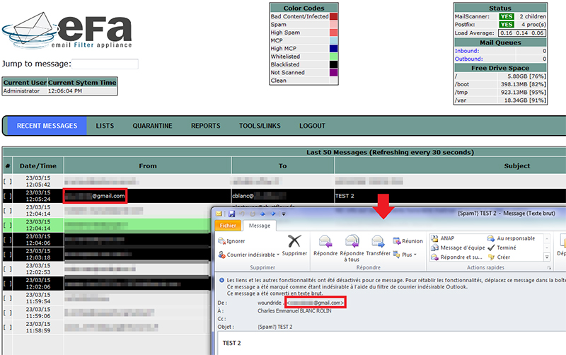

I've tested to add on Web Gui as you said and I've relaod, end even restart MailScanner service, the message is tagged "blacklisted" in the Web Gui, but I receive the message :

Re: Blacklist comlete email address
Posted: 23 Mar 2015 20:48
This is a MailScanner configuration problem. MailScanner "blacklists" emails by marking them as spam in its engine. If the spam action is set to deliver, it will still be delivered.
What does your "Spam Actions" and "High Spam Actions" have set?

First, I kept default configuration :
Spam Actions = store custom(spam)
And no High Scoring Spam Actions.
I've see the file :
/usr/lib/MailScanner/MailScanner/CustomFunctions/CustomAction.pm
But it's not easy for me to configure with this file...
So, in MailScanner.conf, I kept :
Definite Spam Is High Scoring = yes
And I've add :
High Scoring Spam Actions = delete
Sincerelly.
