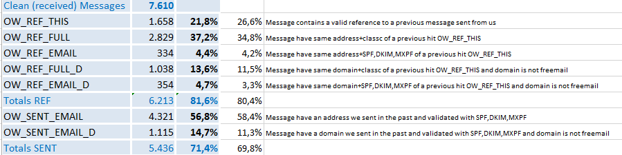

Hi to all,
I am pleased to announce that OW plugin in conjunction with MXPF plugin give near 82% of hit on clean incoming ham messages (after about 2 months of training)
This means that 82% of incoming messages belongs to someone that answered to an email that someone sent from your efa box
OW plugin is usable ONLY if the efa box is used to send and receive, MXPF is Always usable
