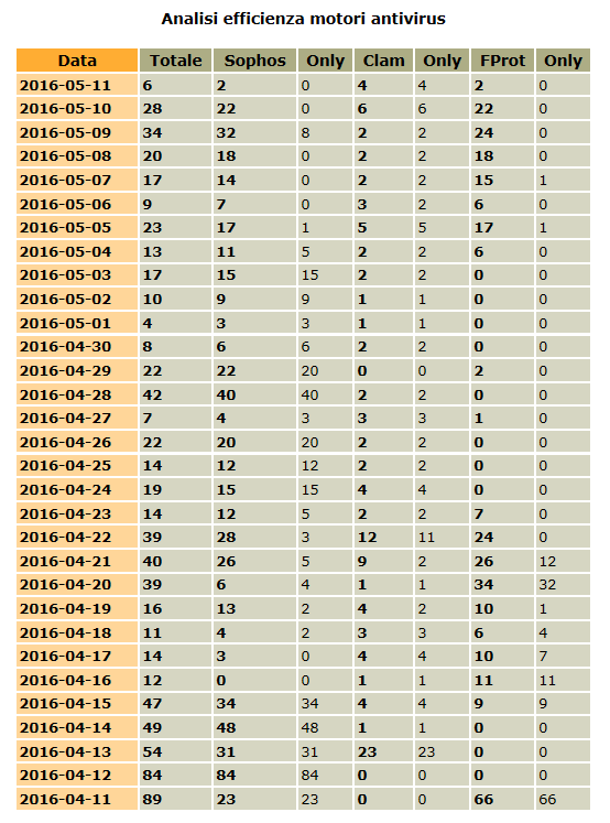

Here my virus detection statistics :
Date Total Sophos Only Clam Only FProt Only
08/04/2016 78 72 22 56 6 0 0
07/04/2016 29 17 17 12 12 0 0
06/04/2016 46 27 27 19 19 0 0
05/04/2016 20 5 5 15 15 0 0
04/04/2016 6 5 5 1 1 0 0
03/04/2016 4 2 2 2 2 0 0
02/04/2016 20 15 15 5 5 0 0
01/04/2016 16 14 14 2 2 0 0
31/03/2016 7 3 3 4 4 0 0
30/03/2016 15 11 6 4 4 5 0
29/03/2016 285 285 167 0 0 118 0
For example 08/04 i found 78 incomingi viruses, Sophos detected 72, 22 was detected by sophos only, Clam detected 56 and 6 only by clam, fprot 0
So if you want you can not install Fprot, but i suggest to install sophos, as you can see
