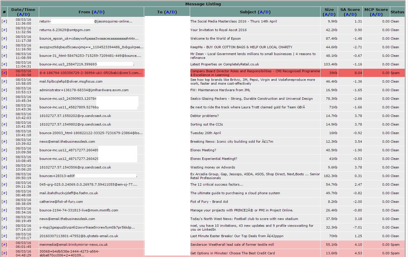

Hi there - i've been running EFA for a few months now and it's working well, except i'm getting far too much spam through to my users.
I could do with some tips on what i can do to make the system more strict about what it lets through.
As it is at the moment, it's pretty much as it is "out of the box". I've attached a picture showing one user with his list of emails today - they are ALL spammy, but only a couple of them have been picked up as spam by the system.
Any suggestions?

You can lower your spam scores in MailScanner.
Lower these values to make EFA more strict.
Required SpamAssassin Score = 4
High SpamAssassin Score = 7

Rather than change the scores, I'd try to find out why the system wasn't marking them as spam in the first place.
When I first had my installation running, a lot of my blacklist/spamlist checks weren't actually running because of how my DNS server was configured. Like you, a lot of spam game through as "clean". Once I identified the problem, and had the spam checks operating correctly, it became much less of a problem.
Perhaps you can look at your spam reports for those messages. You could even forward one of those messages to someone else to see how their system scores the message.
