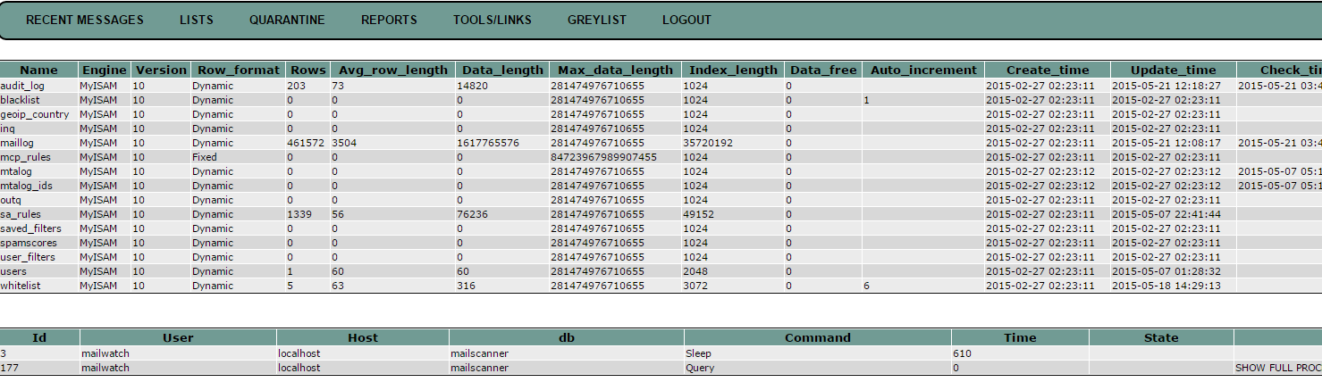

However this time it seems that there was a problem on the inbound side, with messages being bounced back to the sender and then constantly redelivered. Consequently it looks like 350K messages processed by EFA !!
There's now a lot of data in the mySQL database and everything is a bit sluggish ....
Any idea if this is a EFA bug that needs fixing and is there any easy way to clean the DB up .....
