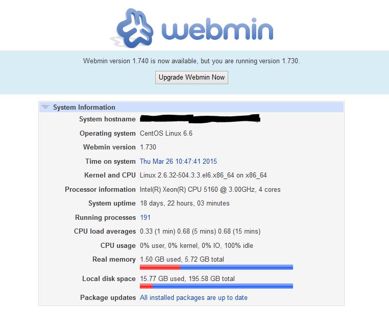

Running E.F.A 3.0.0.7. Running Webmin 1.730. Login to Webmin and presented with a button to upgrade Webmin version from 1.730 to 1.740. I click the button, it finishes downloading then fails to update:
.. download complete.
Failed to upgrade from http://www.webmin.com : RPM signature verification failed :
/tmp/.webmin/12889_23282_2_upgrade.cgi: (SHA1) DSA SHA1 MD5 GPG NOT OK
I attached screenshots. This is a screenshot of the system info screen.
System Information screen
This is the screen showing the update failed after clicking the upgrade button
Failed to verify
Failed to verify
Is there a way to upgrade Webmin through shell? Or manually download and install it?
