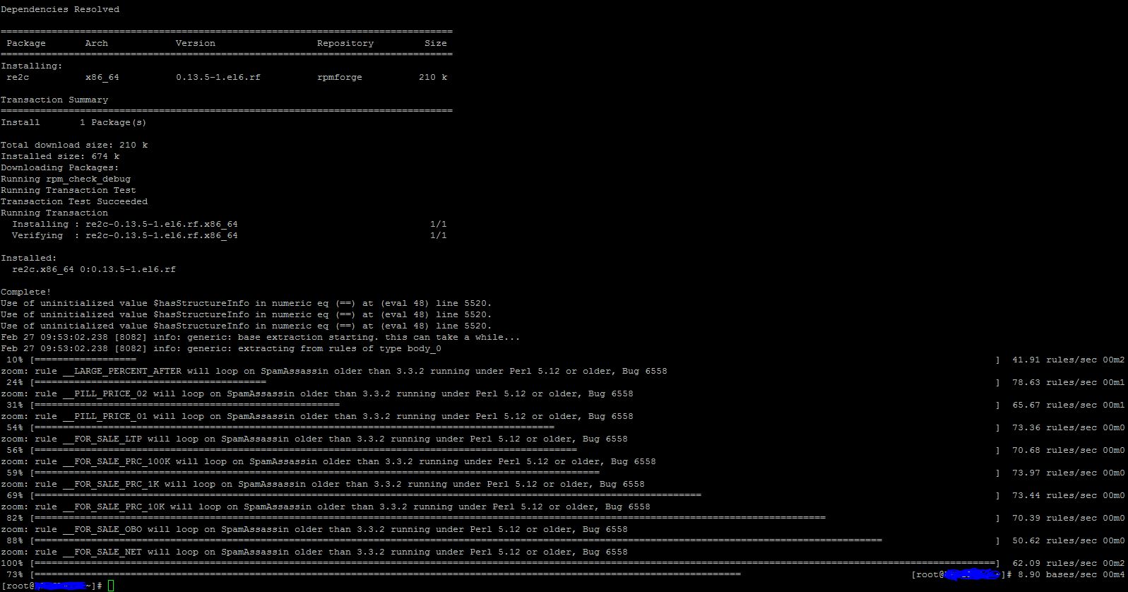

Now i've got an update-success-mail, but the updatelog shows:
After 73% there is no log. How can i be shure the update is realy successful?
Console output from PuTTY (SSH):
zoom: rule __FOR_SALE_NET will loop on SpamAssassin older than 3.3.2 running under Perl 5.12 or older, Bug 6558
91% [================================================================================== ] 60.13 rules/sec 00m02s LEFT
93% [================================================================================== ] 70.39 rules/sec 00m01s LEFT
96% [================================================================================== ] 73.70 rules/sec 00m00s LEFT
98% [================================================================================== ] 63.56 rules/sec 00m00s LEFT
100% [==================================================================================] 62.09 rules/sec 00m23s DONE
//no text here, what is the script downloading?
0% [ ] 0.00 bases/sec --m--s LEFT
73% ================================================================================== ] 28.90 bases/sec 00m40s LEFT
73% [================================================================================
Fri Feb 27 09:57:32 2015
----------------Console output from PuTTY (SSH):
- 3.0.0.7 console log.JPG (177.88 KiB) Viewed 12035 times

That is the last thing that happens in the script. I am thinking you are fine.DaN wrote:After 73% there is no log. How can i be shure the update is realy successful?
Run a lint test in MailWatch to verify that Spamassassin and MailScanner are ok
