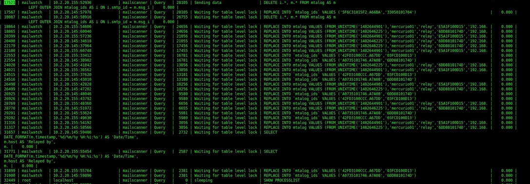

Hello, we have a lock problem in the database mailscanner.
informations:
-Database size - 3.3GB
- EFA SQL 5.1 SGDB
- EFA-Version - EFA-3.0.1.5
After the purge activation in the EFA was made troubleshooting in SQL 5.1, the EFA mailscanner database has been identified "Locked" with the "mtalog" and "mtalog_ids" tables for DELETE in the smtp_id and msg_i columns.
Script execution - /etc/cron.daily/mailwatch = /usr/local/bin/mailwatch/tools/Cron_jobs/db_clean.php >> /dev/null 2>&1
Query in the Script cause lock database:
// Cleaning the mta_log and optionally the mta_log_id table
$sqlcheck = "SHOW TABLES LIKE 'mtalog_ids'";
$tablecheck = dbquery($sqlcheck);
$mta = get_conf_var('mta');
$optimize_mtalog_id = '';
if ($mta == 'postfix' && mysql_num_rows($tablecheck) > 0) {
//version for postfix with mtalog_ids enabled
dbquery(
"DELETE i.*, m.* FROM mtalog AS m
LEFT OUTER JOIN mtalog_ids AS i ON i.smtp_id = m.msg_id
WHERE m.timestamp < (NOW() - INTERVAL " . RECORD_DAYS_TO_KEEP . " DAY)"
$optimize_mtalog_id = ', mtalog_ids';
} else {
dbquery("DELETE FROM mtalog WHERE timestamp < (NOW() - INTERVAL " . RECORD_DAYS_TO_KEEP . " DAY)");
Lock database mailscanner - mtalog and mtalog_ids
- mayconplanet
- Posts: 5
- Joined: 30 Sep 2016 01:31
- Lock-mtalog.png (618.83 KiB) Viewed 707797 times

After running MYSQL-RECOVERY the table continues with "Lock" mtalog and mtalog_ids when you run the mailwatch script in the CRON.Daily routine.
What impact will be caused if you do not choose to execute this Query, as already commented in Script - That execution is optional

out of the blue I'm also having this issue... every day my eFa install stops processing mails and if I check the mysql process list I see this "DELETE i.*, m.* FROM mtalog..." query with a very high runtime and it seems it blocks eFa from processing mails.
this issue appeared seemingly out of nowhere... there was no update or anything before it started... I updated to 4.0.4-42 and then ran but it did not solve the issue - this query seems to be running forever...
I ran mysqlcheck and it gave everything an OK.
how could I solve this? is there a way to just empty out both tables without breaking everything?
I just checked the mysql tables.. and maybe the cleanup of mtalog_ids never actually worked:
mtalog: 207329 entries 91MiB
mtalog_ids: 11995488 entries 2,5 GiB
so I guess the join operation is maybe overwhelming the server seeing the size of the mtalog_ids table?
seems to me that this table might never have been cleaned since the server started running...
run-parts /etc/cron.dailyI ran mysqlcheck and it gave everything an OK.
Re: Lock database mailscanner - mtalog and mtalog_ids
Okay so here is my "solution":
first I cleared the mtalog_ids table without using a join:
(I ran this multiple times with a bash script and pause in between until there where no rows affected anymore).
then I also had so cleanup the mtalog like this: (my time keep interval is 14 days)
and then I ran:
and then I could run the original DELETE (with join) statement and it finished fairly quickly.
DELETE FROM mtalog_ids WHERE smtp_id not in (SELECT msg_id FROM mtalog) LIMIT 100000;then I also had so cleanup the mtalog like this:
DELETE FROM mtalog m WHERE m.timestamp < (NOW() - INTERVAL 14 DAY);and then I ran:
OPTIMIZE TABLE mtalog, mtalog_idsCode: Select all
DELETE i.*, m.* FROM mtalog AS m LEFT OUTER JOIN mtalog_ids AS i ON i.smtp_id = m.msg_id WHERE m.timestamp < (NOW() - INTERVAL 14 DAY);Re: Lock database mailscanner - mtalog and mtalog_ids
