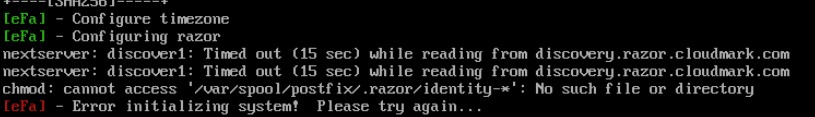

I am getting an "error Configuring Razor"
Fresh install of Centos Stream 9
updated successfully after install (So it has Internet Access)
Install using curl..... | bash
All downloads OK
After a Reboot go to the Web page
Run through all the questions and off it goes
Up comes the error. It doesn't give a lot away
(I'm sure I have had this same error on EFA 4 setup previously)
I logged into the CLI and tried again.
Ran through - the only question I answered differently was DNS (after reading some posts on here)
Same issue, but the error is a little more descriptive this time:
[eFA] - Configuring Razor
nextserver: discover1: Timed out (15 sec) while reading from discovery.razor.cloudmark.com
chmod: cannot access '/var/spool/postfix/.razor/identity-*': No such file or directory
[eFa] - Error initializing system! Please try again...

Interestingly it is getting stopped at the firewall.
It is in a rule "IP to Any service and any destination allow" towards the top of the ruleset
Yet it is hitting the deny all last rule - with a layer 7 deny rule for the application cloudmark-desktop using port 2703
so I will investigate further!
Cheers
Frank
elfranko
Posts: 25
Joined: 03 Sep 2018 08:03
Re: EFA 5 Setup Error Razor
Post by elfranko »
To set up razor the appliance needs to access the internet using port TCP 2703
The only way you know it hasn't worked is the error message in the original post.
Once I enabled outbound access for TCP/2703 on the firewall it was a happy machine.
