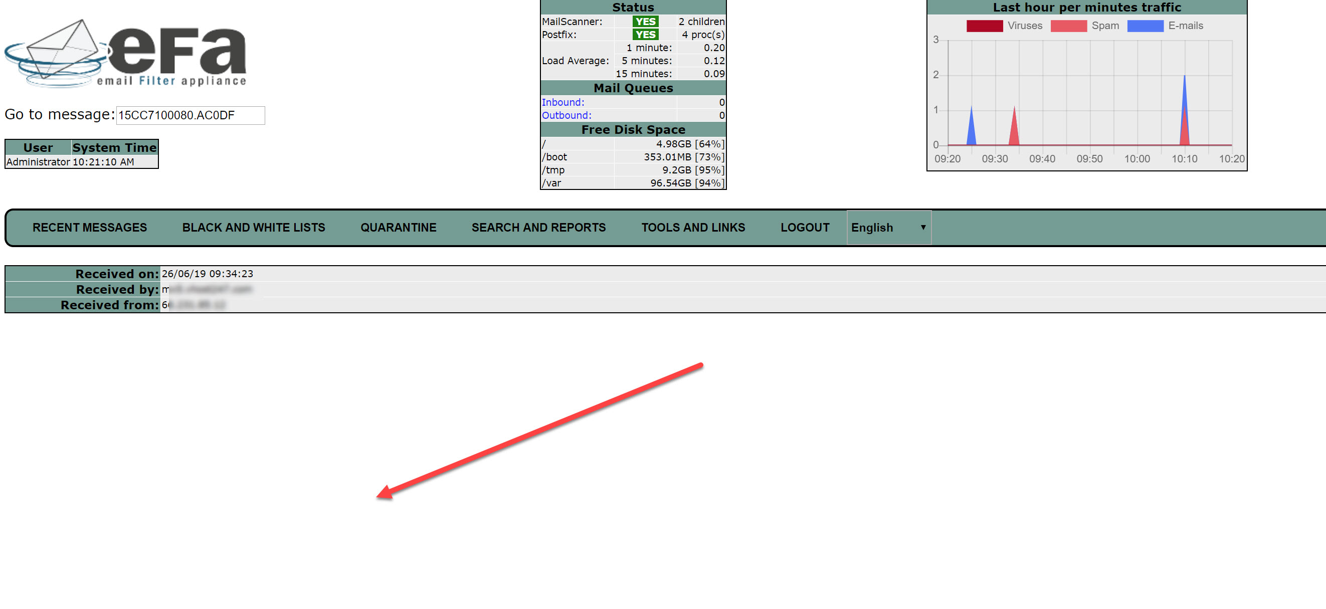

I'm running EFGA 3.0.2.6 and I think for the most part its working well

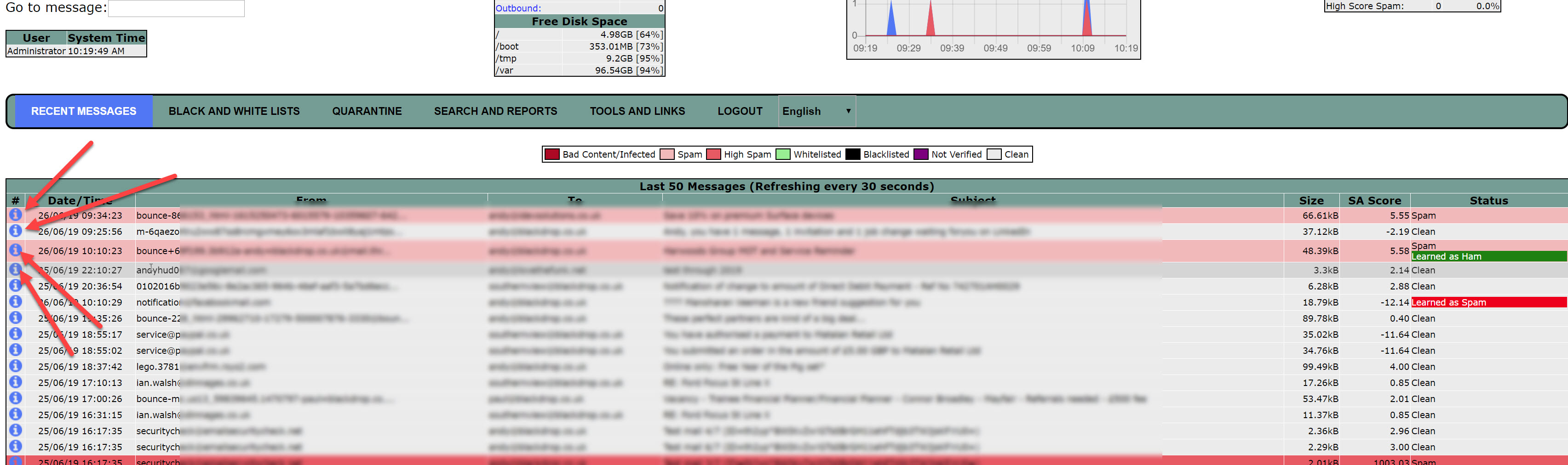

However, I've noticed that in my install if I click on any message in the EFA Gui list.. like below.. literally any of them
The only info I get back is these lines.. I dont get all that detailed info...
Wondering whether my install is corrupt. Can't recall when it happened - maybe when I updated to 3.0.2.6
Any thoughts appreciated

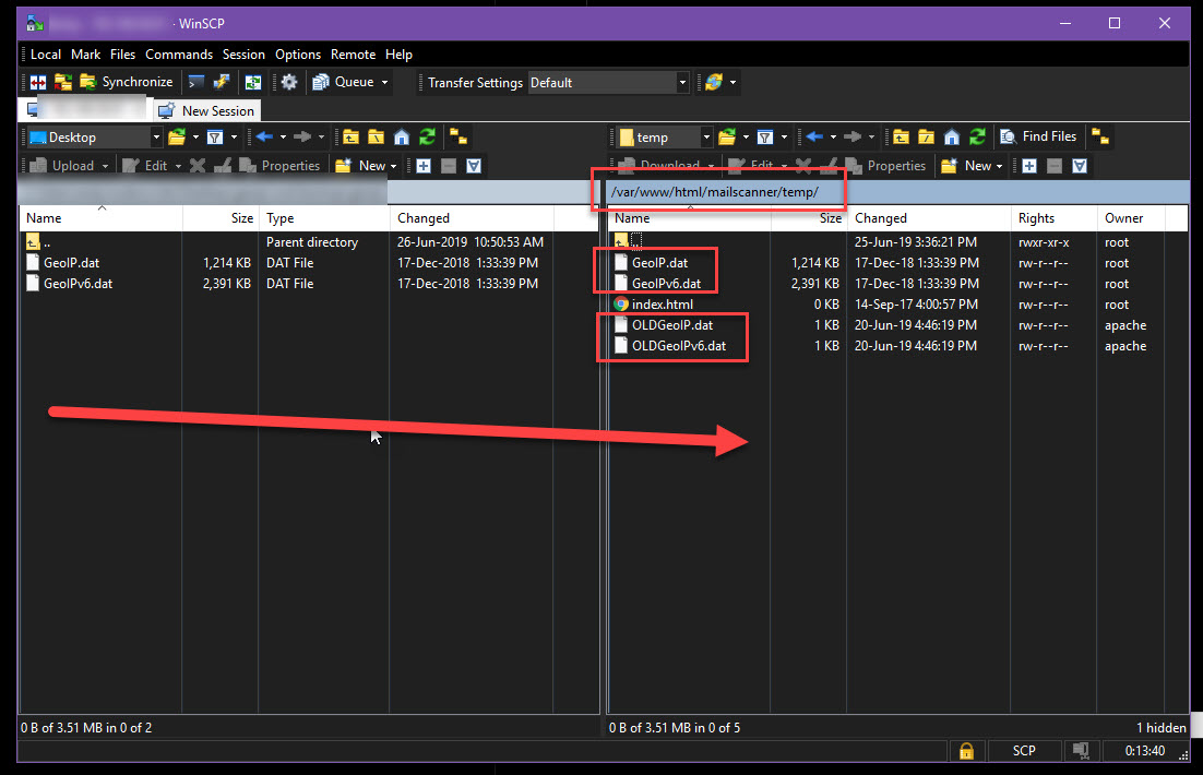

ok - So I've fixed this
I had to update the GeoIP Database files in /var/www/html/mailscanner/temp with new ones for it to work properly. I'm on EFA 3.0.2.6
I installed WinSCP on my Windows 10 Machine and downloaded the updated GeoIP file from here:
download/file.php?id=418
Then on the console of my EFA VM I had to enable SSH for Root by modifing this file:
Modify /etc/ssh/sshd_config to allow root login (PermitRootLogin yes)
I then rebooted my EFA
I could then login to it with WinSCP and used WinRar on my Windows PC to extract the tar.gz file above. I then copied the files over to directory as shown below
I renamed the old files with "OLD" in front of them first
Then I restarted Mailscanner on the console of EFA with
"service mailscanner stop"
and
"service mailscanner start"
Then relogged into the EFA gui and now all the info is showing correctly
