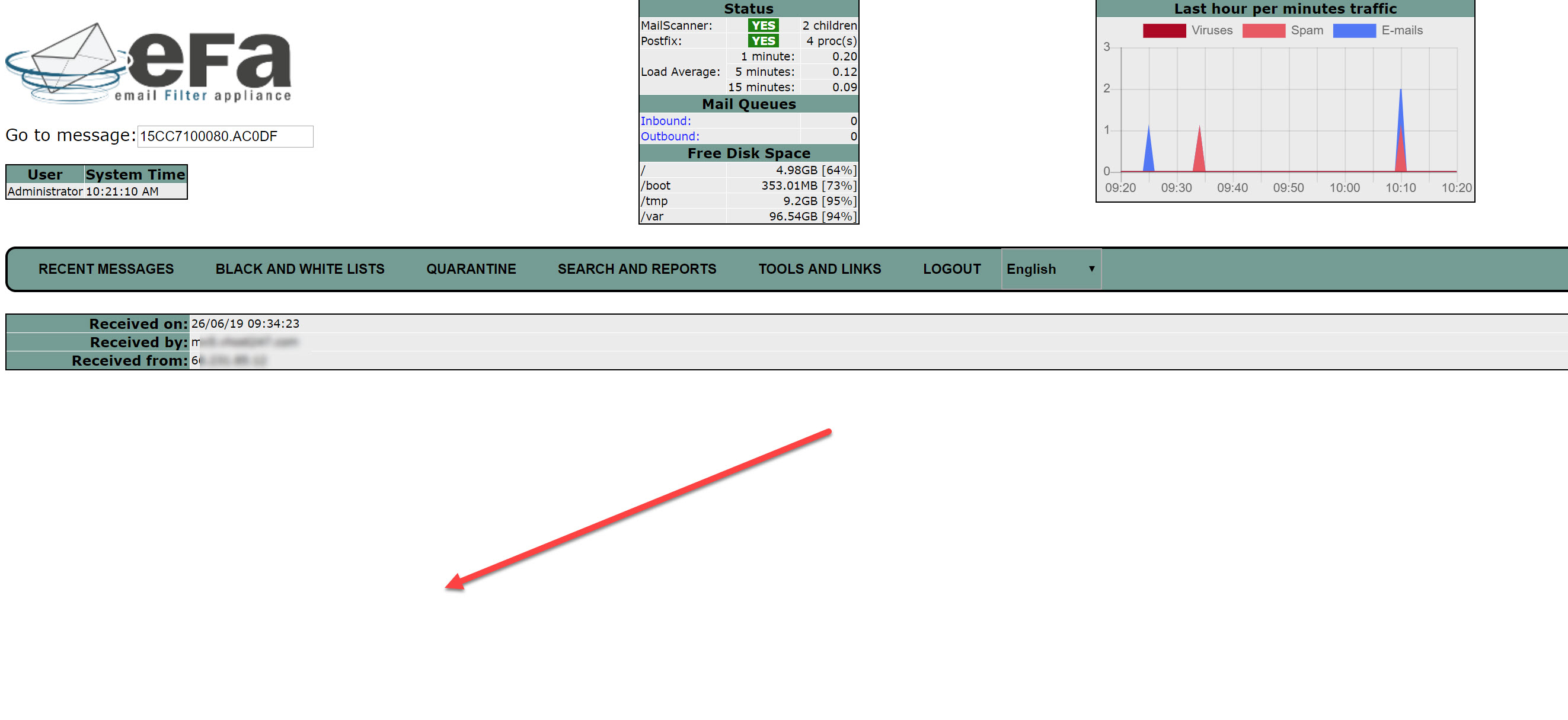

Hi Guys
I'm running EFGA 3.0.2.6 and I think for the most part its working well
However, I've noticed that in my install if I click on any message in the EFA Gui list.. like below.. literally any of them
The only info I get back is these lines.. I dont get all that detailed info...
Wondering whether my install is corrupt. Can't recall when it happened - maybe when I updated to 3.0.2.6
Any thoughts appreciated

ok - So I've fixed this
I had to update the GeoIP Database files in /var/www/html/mailscanner/temp with new ones for it to work properly. I'm on EFA 3.0.2.6
I installed WinSCP on my Windows 10 Machine and downloaded the updated GeoIP file from here:
download/file.php?id=418
Then on the console of my EFA VM I had to enable SSH for Root by modifing this file:
Modify /etc/ssh/sshd_config to allow root login (PermitRootLogin yes)
I then rebooted my EFA
I could then login to it with WinSCP and used WinRar on my Windows PC to extract the tar.gz file above. I then copied the files over to directory as shown below
I renamed the old files with "OLD" in front of them first
Then I restarted Mailscanner on the console of EFA with
"service mailscanner stop"
and
"service mailscanner start"
Then relogged into the EFA gui and now all the info is showing correctly
Hope this helps anyone with same issue
Andy
