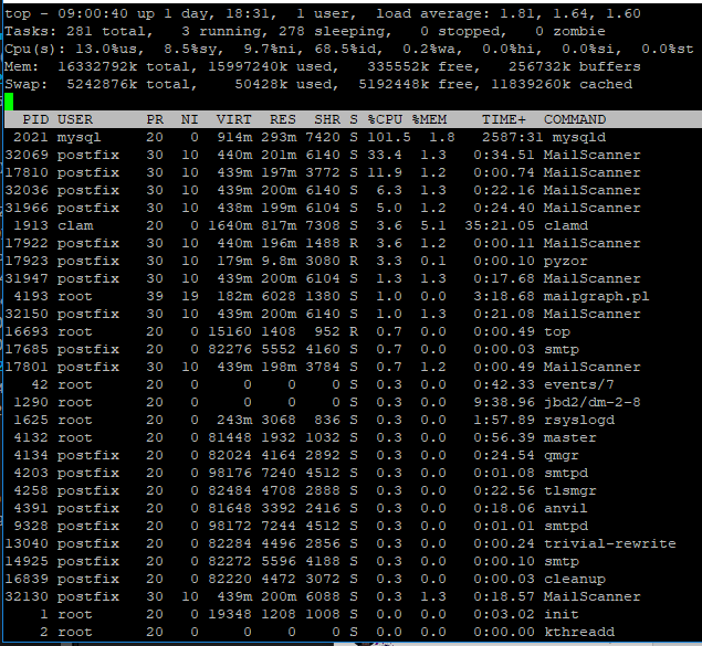

I suspect your sql instance isn't configured to use enough memory.
Can you give me a "top" screenshot showing your mysqld.

Re: Database issue not assigning token.
Posted: 26 Oct 2018 13:02
by ethandee178
Looks like a high cpu %.
Posted: 29 Oct 2018 04:13
So, there is something funny going on with your mysql. What, I'm not sure.
One good thing is your IO Wait is low (0.2%wa) which would normally indicate a problem with writing to the disks if it were high.
And your memory allocation seems reasonable, so that shouldn't be it.
And your system has enough ram, so that's not it...
