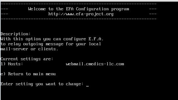

Check out EFA-Configure
8) Mail Settings --> 1) Outbound mail relay
Put your exchange server addy in here :D

I have checked that several times, has been in there since beginning.
Re: EFA and Exchange
Try the ip too and make sure it resolves from the EFA.

OK, so DNS does resolve, however i changed it to the IP address and it is getting better results. Messages are going out now, yet seem to time out when connecting to other mail servers.
I have a feeling that is an issue on my end, and I am looking into it.
