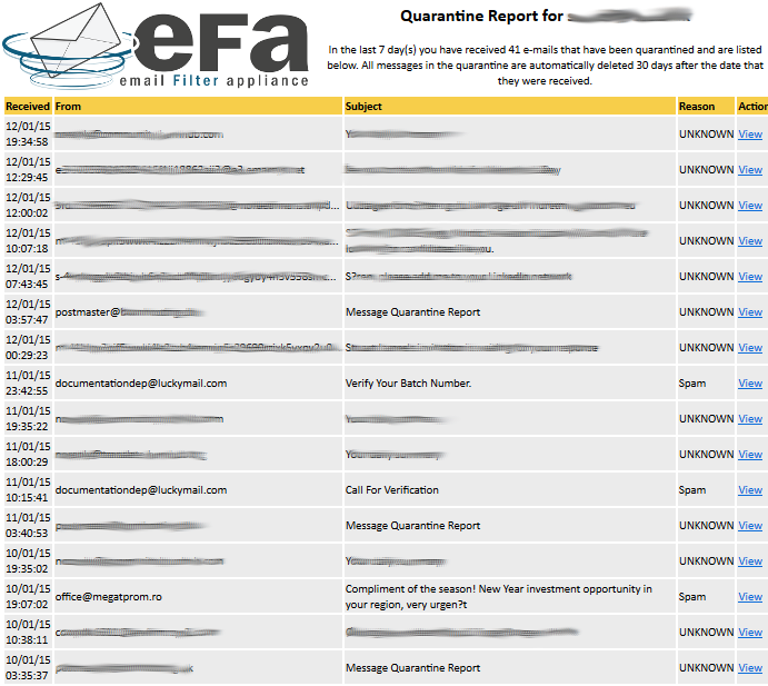

Hello EFA,
My server have begun to show none spam mails in my daily quarantine mail as unknown, this is something that started some time ago, but have not done it all the time.
How do I avoid this when I also want all emails to be stored on the server so that users can restore any deleted mails
