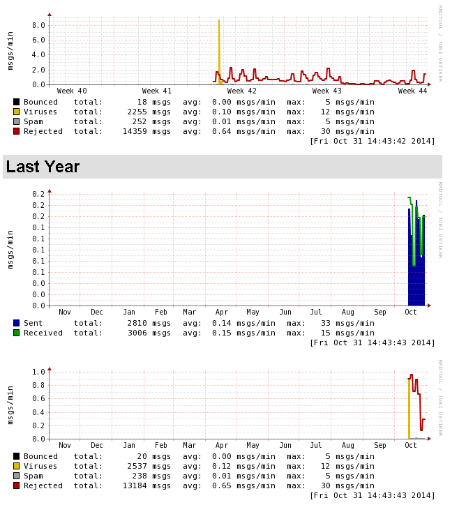

I have an EFA install that has been running for three weeks, and the stats also don't add up
incorrect stats
incorrect stats
efa stats.png (38.37 KiB) Viewed 8710 times

Those graphs are correct.
Reason:
messages/min is averaged for each value along the graph.
The first graph shows greater detail than the past year graphs. This is because the each value plotted represents a greater unit of time (such as an entire week instead of an individual day)

Thanks shawniverson. Please move this post to how to section. It will benefits others. Looks like its by design rather than bug report.
