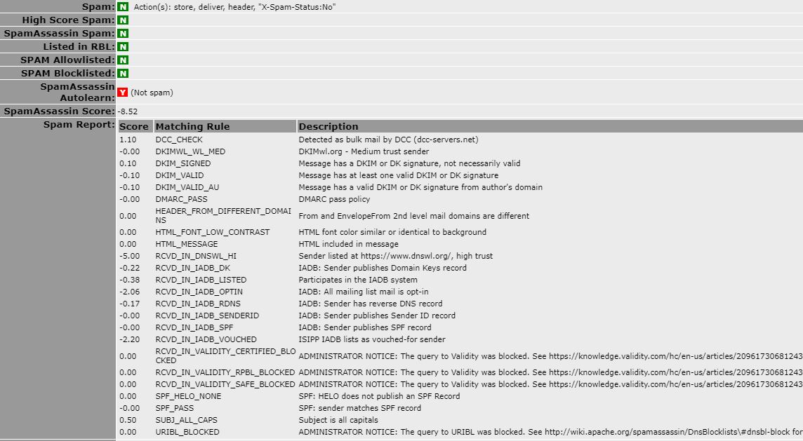

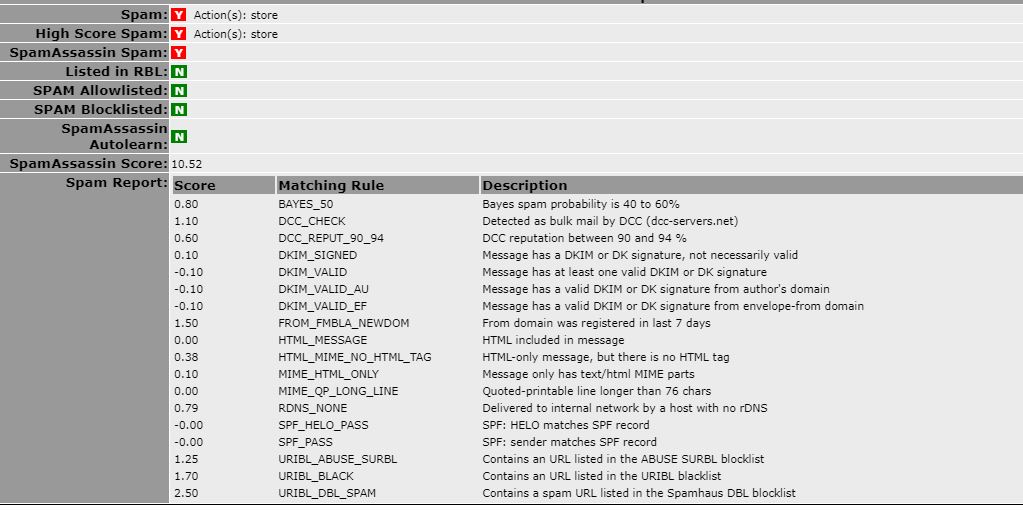

When going from EFA 4 to EFA 5 I'm getting quite a few messages come through that used to be blocked as spam (they are unsolicited spam). I guess this is completely a function of the spamassasin version and settings, so just looking for suggestions on how to get these to score as spam.
Here's the scoring for an almost exact same message in EFA 4:
And in EFA 5:

Those mails may be similar but are not the same. Chances are the sender domain is not the same...
The second email hit RCVD_IN_DNSWL_HI, which is the bulk of the negative scoring
You also have some problems....
You have no Bayes scoring happening currently. You might need to retrain your Bayes DB.
You are being blocked by Validity and URIBL, so results of those lookups did not occur. Make sure you are using recursion for DNS lookups to avoid this problem, see the following topic for more info:
viewtopic.php?t=934
