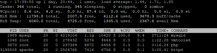

In some hours of the day my efa take long time to deliver because to much emails incoming accumulate on Milter Inbound
Screenshot 2024-04-11 173859.png (3.62 KiB) Viewed 41447 times
I found that mysqld daemon is at 100% of a single cpu also i have 16 cpu on box
I think that this is milter problem that cant split on more queues, is possible to have more milter ?

Hi Nicolca,
can you show your Mysql config
/etc/my.cnf.d/mariadb-server.cnf

and Mysqltuner ouput?
Sice there's swapfile use, check
cat /etc/sysctl.d/vm.swappiness.conf
Source and howto: https://mariadb.com/kb/en/configuring-swappiness/
(Assuming your Unbound recursive DNS service is checked and ok and you checked the logfiles)

I agree with henk this isn't a milter problem. The Milter Inbound count are emails that are in the queue after being processed by the milter, so the bottleneck is elsewhere.
Are you on the latest release of eFa 4? There are some performance fixes that will directly impact mariadb utilization as well.
