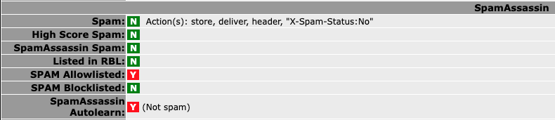

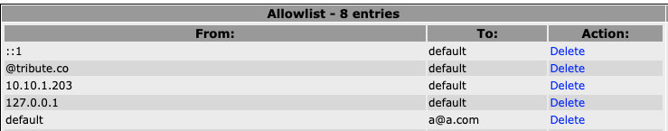

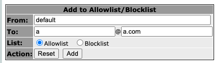

Re: efa mail not filtering just one account
Posted: 20 May 2023 10:47
efagokan1 wrote: 17 May 2023 11:19 Example: b@b.com, c@c.com, d@d.com addresses send us e-mails. My email address is a@a.com. No email from me should be filtered, but all other emails from a.com should be filtered.
Solution:
From: default
To: a@a.com
List: allowlist
Action: Add
Screenshot 2023-05-20 at 18.44 1.png (15.07 KiB) Viewed 16412 times
Screenshot 2023-05-20 at 18.45.png (21.11 KiB) Viewed 16412 times
Screenshot 2023-05-20 at 18.44.png (28.13 KiB) Viewed 16412 times
And now all messages to a@a.com are whitelisted and do not get spamchecked.
