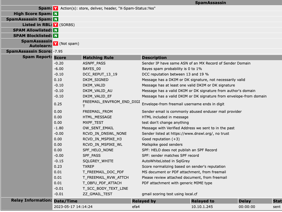

Posted: 17 May 2023 06:36
Well, that was quick!
Have a look at this:
- Screenshot 2023-05-17 at 14.28.png (160.56 KiB) Viewed 19225 times
These are the settings I put in my MailScanner.conf
Spam List = BARRACUDA SORBS SPAMHAUS SPAMCOP
Spam Lists To Be Spam = 1
Spam Lists To Reach High Score = 2
This spam had a -8 score (non spam) but was found in the SORBS rbl list. Since I had set the 2nd option = 1, then it was flagged as spam even with the really low SA score. And, it was definitely spam even though the bayes filter didn't think so.
So now I should be able to catch spammy messages that were otherwise getting through my SA filter. Wonderful!
Now I will need to create a report that checks for "Listed in the RBL = Y" and "SpamAssassin Spam = N" so I can find potential messages that need retraining.
