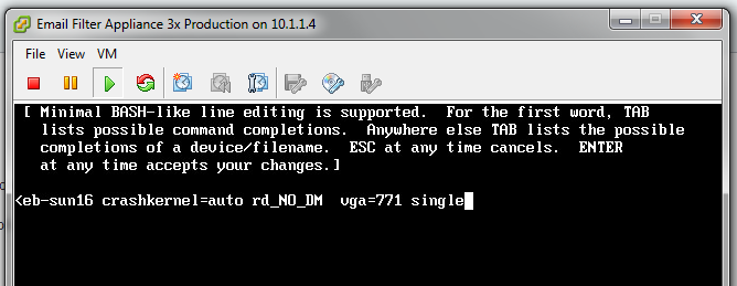

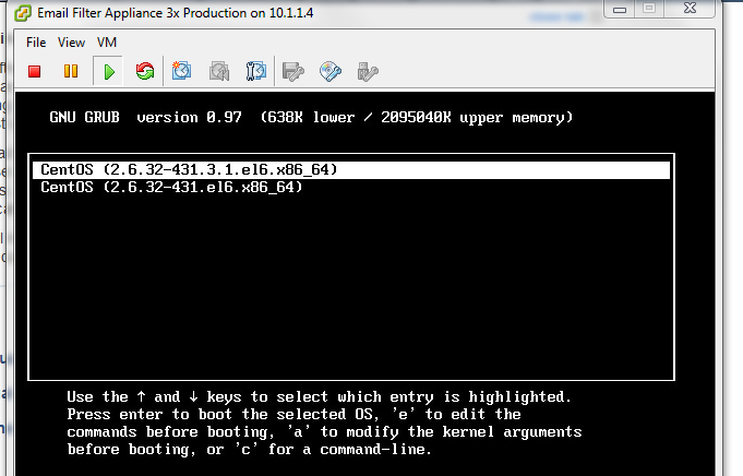

5) Start your EFA and have the console open. When the countdown appears, press a key to interrupt automatic boot
6) Press 'e' to edit the boot options, arrow down to the line starting with "kernel", press 'e' again, and add 'single' to the end of the line with a leading space
7) Press enter and 'b' to boot. This will take you to single user mode (init level 2)

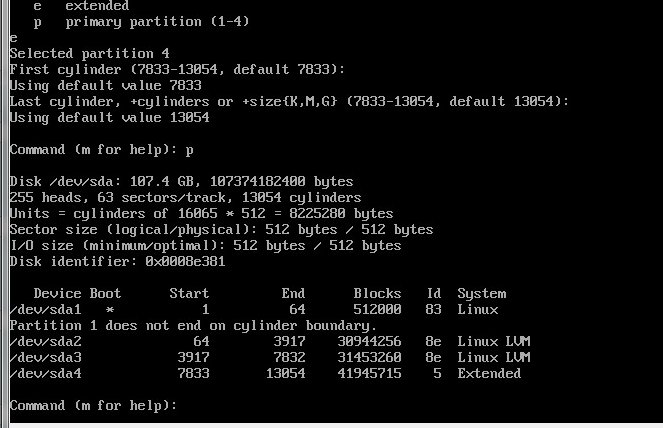

9) Create a new partition
9a) Press n to create a new partition
9b) If you already have 3 partitions, choose extended 'e' <enter>, otherwise choose primary 'p' <enter>
9c) Accept the default first cylinder <enter> and last cylinder <enter>
9d) If you created an extended partition in step 9b, create a new partition again, accepting defaults for cylinders.

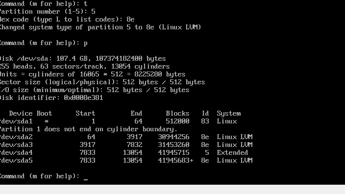

9e) Press 'p' to view partitions again, and note the name of the new Linux partition. Press 't' <enter> to change the partition type.
9f) Choose the appropriate partition, press <enter>, and enter '8e' for the type <enter>
9g) Check your work with 'p' <enter>. If satisfied, type 'w' <enter> to save your work.

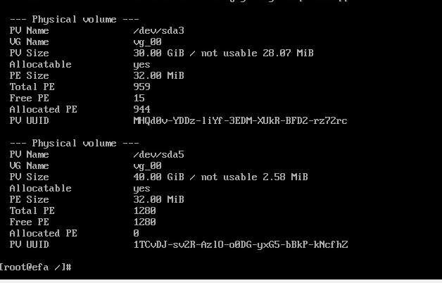

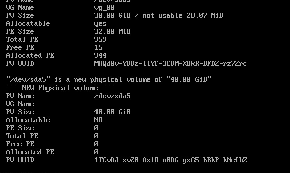

11) Add the new partition to the LVM pool
Run pvcreate (changing /dev/sda5 with the name of your newly created partition)
pvcreate /dev/sda5
pvdisplay
You should see a new PV. Now add the PV to the volume group, replacing /dev/sda5 with your partition.
vgextend vg_00 /dev/sda5
pvdisplay

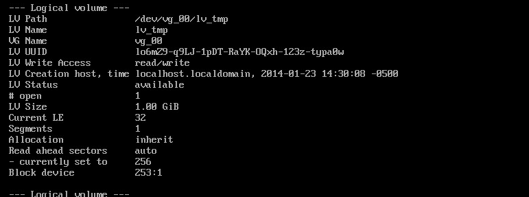

12) Now it is time to resize the logical volume. I will demonstrate with /tmp (you can also increase /var or / this way). Because these volumes are mounted, we will perform a live resize.
lvdisplay
13) Making note of the LV Path, execute the following, substituting the device and size that you desire
lvextend -r /dev/vg_00/lv_tmp -L +10G
