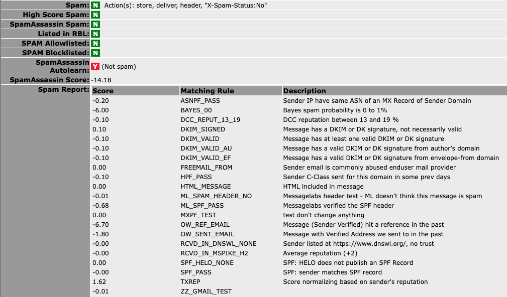

I added the following rules into /etc/mail/spamassassin/local.cf
header       ZZ_GMAIL_TEST From =~ /\@gmail\.com/i
score        ZZ_GMAIL_TEST -0.01
describe     ZZ_GMAIL_TEST gmail scoring test using local.cf
I don't know if it matters or not, but I did not use tabs as field separators.
I did not run sa-update and/or sa-compile. In fact these scripts are not in /etc/mail/spamassassin on my installation, but in /usr/bin. I also did not restart any processes.
I then sent an email from my gmail account to the account protected by efa4 and here is what I got:
Screenshot 2022-10-06 at 18.31.png (134.61 KiB) Viewed 20126 times
so the rule clearly works.
The missing description is correct as I did not run the "Update SpamAssassin Rule Descriptions" from the "Tools and Links" menu.

Since I created the rule, there were several updates and restarts of the system. Never the less, I've re-checked all the recent 20 mail from gmail and the rule was applied just fine. I had the problem with the rule not being applied every time only after I created the rule some months ago.
So, from my side the sa-compile mentioned previously helped and everything is fine now.
