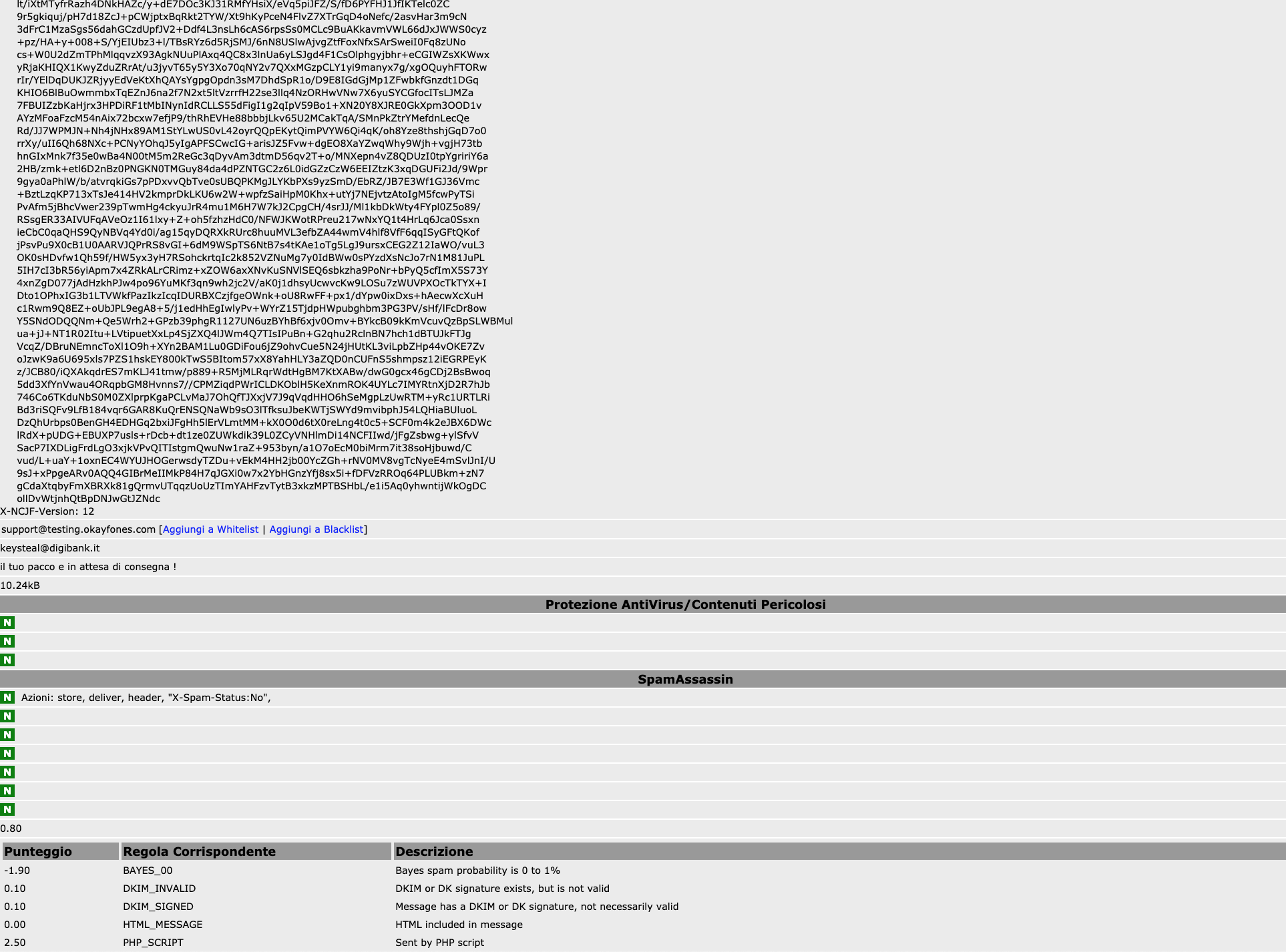

This is a recent example:
An example
An example
Schermata 2021-11-02 alle 21.42.04.png (369.35 KiB) Viewed 8427 times

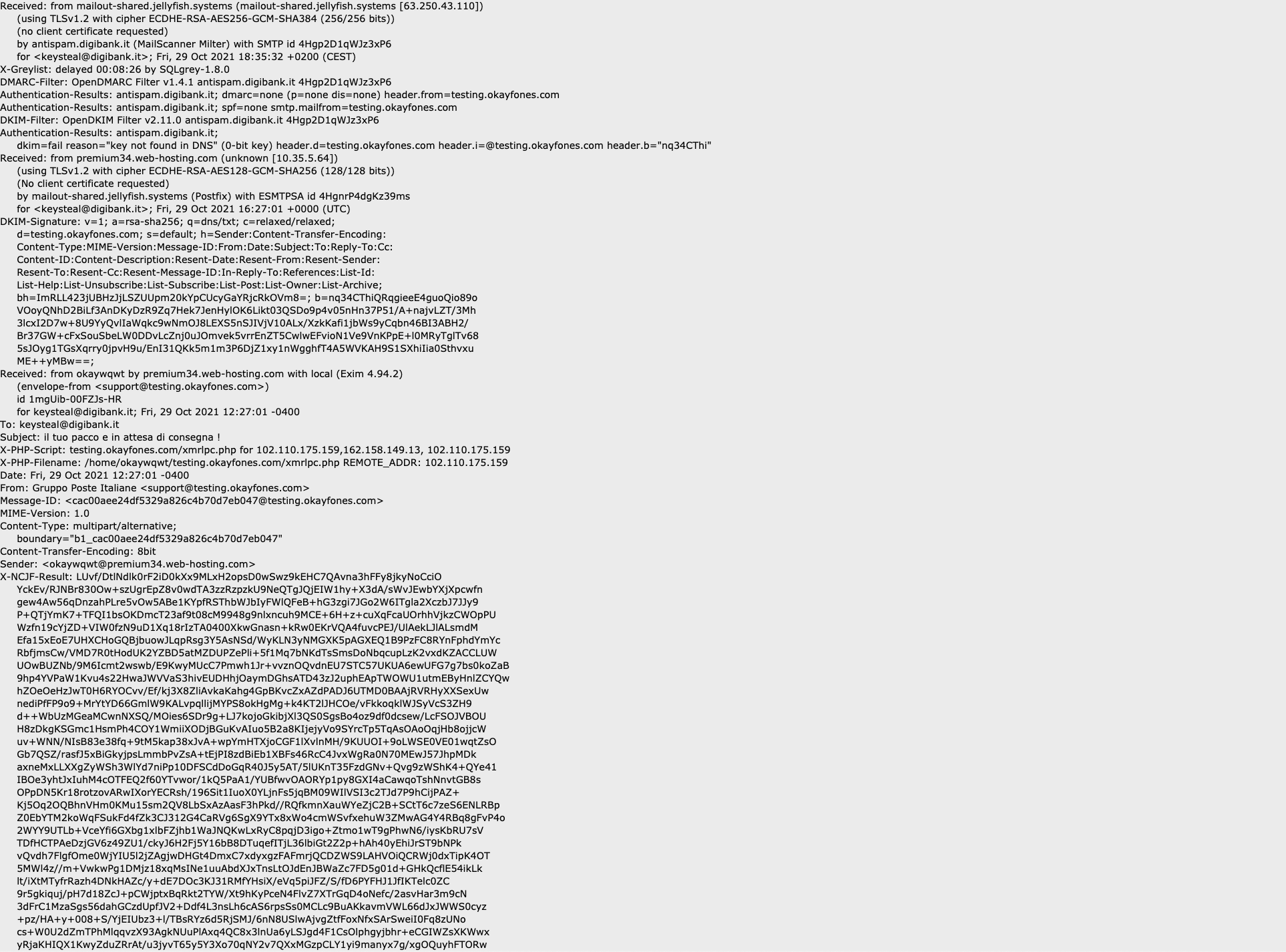

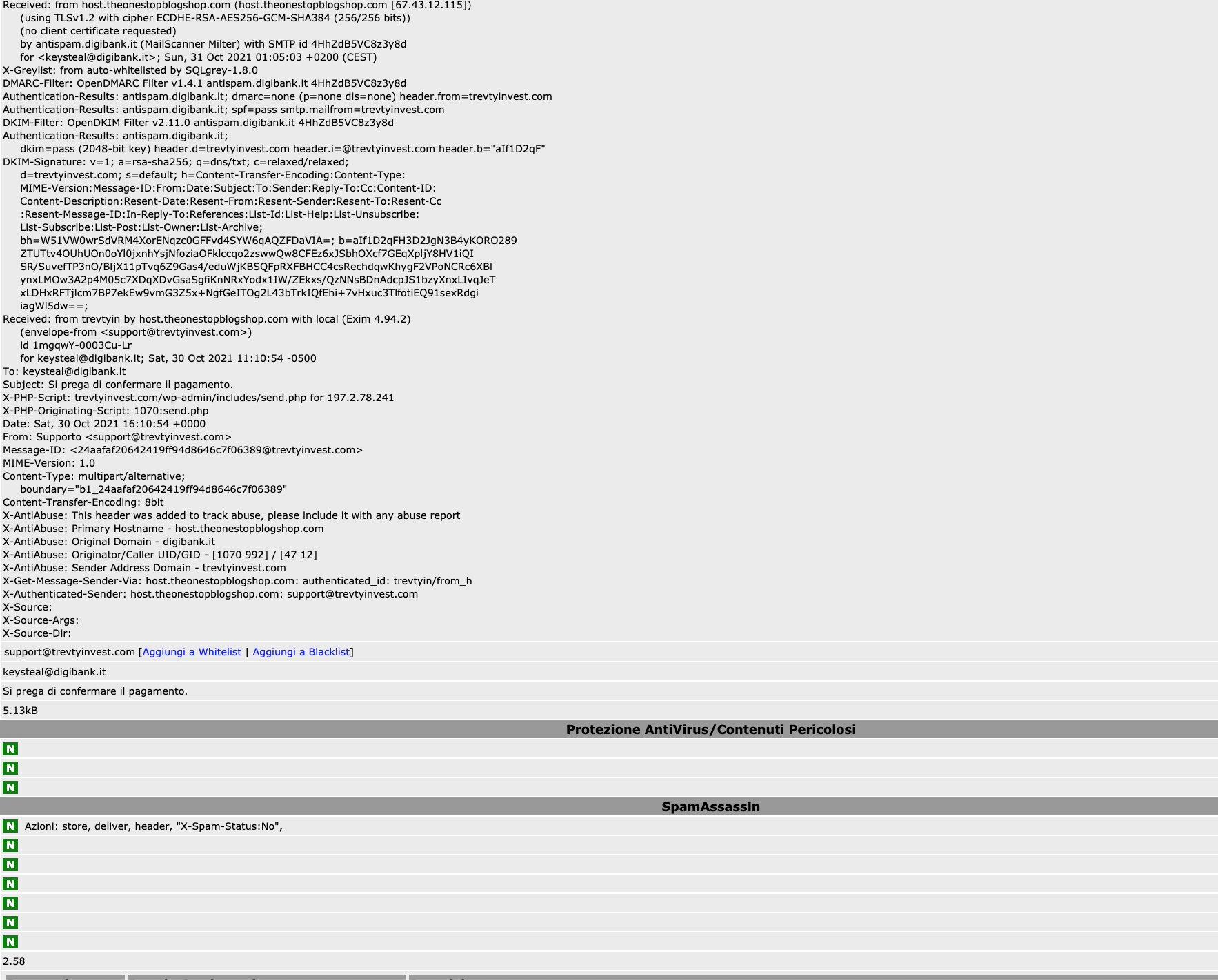

Re: best practise or best configuration
Posted: 02 Nov 2021 20:50
by keysteal
Another one:
Schermata 2021-11-02 alle 21.49.01.png (611.59 KiB) Viewed 8427 times
Schermata 2021-11-02 alle 21.50.36.png (488.36 KiB) Viewed 8427 times
Posted: 03 Nov 2021 15:47
The first thing I spot is a DKIM_INVALID. So, you could assign a higher score to incoming emails that have a DKIM_INVALID.
I'll look at these in greater detail later and give you some suggestions and steps to take.
