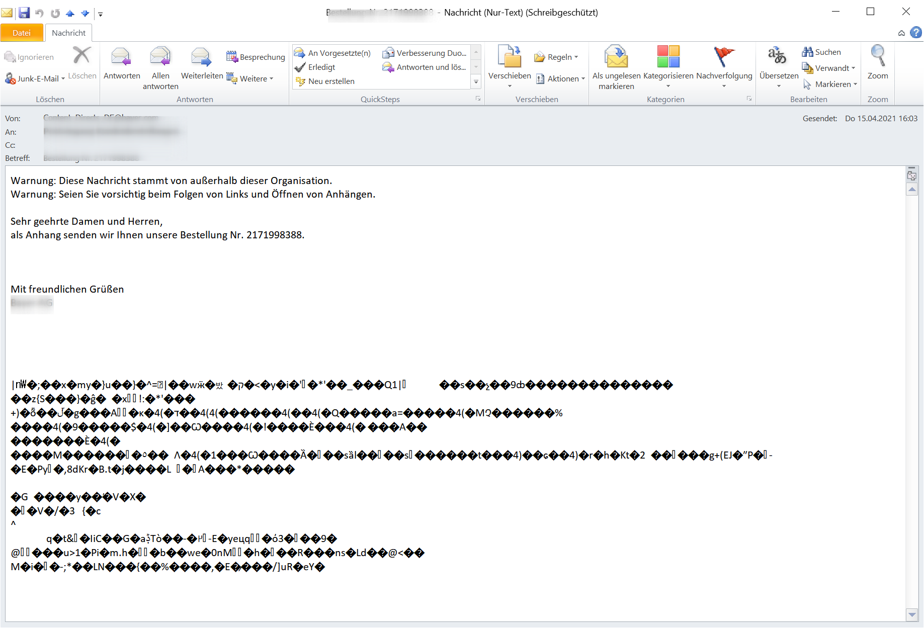

We are having maybe a similar problem with misspelled messages arriving from one single sender domain. (automated system creating e-mails with PDF attachments.)
When they arrive and transferred to our internal exchange server, the PDF attachment is not visible but partly corrupted text:
img-2021-05-04 15.46.33.png (142.5 KiB) Viewed 232961 times
In the MailWatch-UI the PDF is mentioned as "partialMessage.bin"
MIME Typ: application/pdf
partialMessage.bin Download
--18446744072854621553-1179195149-1618495305=:2667
Content-Type: application/pdf;
        name="=?UTF-8?B?QmVzdGVsbHVuZyBOci4gMjE3MTk5ODM4OC5wZGY=?="
Content-Transfer-Encoding: BASE64
Content-Disposition: attachment
---removed data---
--18446744072854621553-1179195149-1618495305=:2667--
If I resend the message via MailWatch-UI to another addressee on the same MTA, the file is correctly shown with the PDF attachment.
Obviously there is a difference when the message arrives at eFa and then examined and forwarded, compared to manually started transmission via MailWatch.
Anybody an idea how to solve it? The sender is a huge international company, which sends us automated purchase orders and we do not want to lose any of it.
BR Andreas

Today again we received a message with the problem already reported:
Message-ID: <4204.3564.2616992.1629086691.830.0@eu.pneu.local>
MIME-Version: 1.0
Content-Type: MULTIPART/MIXED; BOUNDARY="1773658847-17789-1629086691=:4204"
From both senders we have now seen the problem they do send automated order confirmations and again we see the "=:" in the boundary.
Any idea how to solve this problem?
