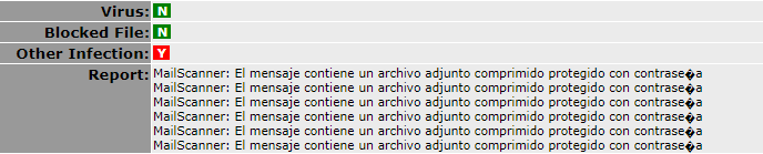

Today one customer didn´t receive a message and when checking if it was blocked, I found that it was blocked because it contained 6 password protected zip files.

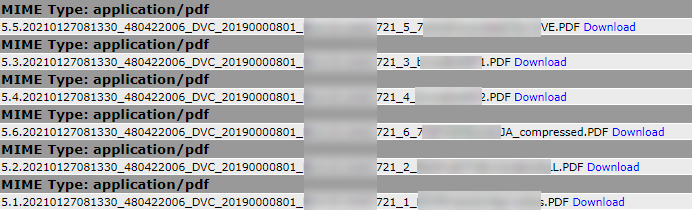

These are the files attached:
I downloaded the pdf files and found one that was corrupt (I could not open it) and it was really a password protected zip file renamed as pdf.
This was correctly detected by MailScanner as password protected zip file, but the other files where just regular pdf files.
Checking my server logs, I found that all files where incorrectly detected as password protected files:

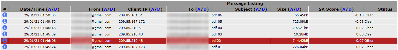

To check if there was a problem with those pdf files, I sent new messages, one per message and only one was detected as password protected file.
individual files
individual files
pdf files independent.png (47.04 KiB) Viewed 2651 times
