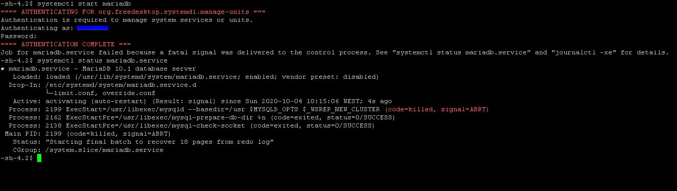

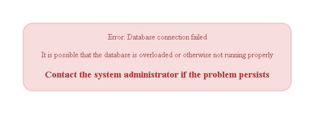

Received an alert regarding Database, tried to login to EFA WEB and this shows up
On the server I got this :o

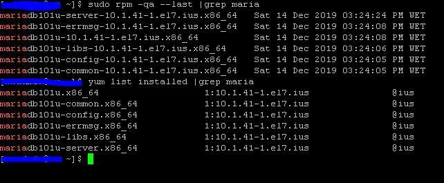

MariaDB-server not installed?
What?

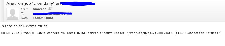

Received Cron email

You jump to conclusions and mixUP Mariadb versions!!
rpm -qa --last |grep maria
mariadb101u-devel-10.1.41-1.el7.ius.x86_64 Sat 29 Feb 2020 09:54:39 PM CET
mariadb101u-server-10.1.41-1.el7.ius.x86_64 Fri 15 Nov 2019 08:16:39 PM CET
mariadb101u-errmsg-10.1.41-1.el7.ius.x86_64 Fri 15 Nov 2019 08:16:21 PM CET
mariadb101u-10.1.41-1.el7.ius.x86_64 Fri 15 Nov 2019 08:16:21 PM CET
mariadb101u-libs-10.1.41-1.el7.ius.x86_64 Fri 15 Nov 2019 08:16:19 PM CET
mariadb101u-config-10.1.41-1.el7.ius.x86_64 Fri 15 Nov 2019 08:16:19 PM CET
mariadb101u-common-10.1.41-1.el7.ius.x86_64 Fri 15 Nov 2019 08:16:19 PM CET
or use yum and also view the repo used
yum list installed |grep maria
mariadb101u.x86_64 1:10.1.41-1.el7.ius @ius
mariadb101u-common.x86_64 1:10.1.41-1.el7.ius @ius
mariadb101u-config.x86_64 1:10.1.41-1.el7.ius @ius
mariadb101u-devel.x86_64 1:10.1.41-1.el7.ius @ius
mariadb101u-errmsg.x86_64 1:10.1.41-1.el7.ius @ius
mariadb101u-libs.x86_64 1:10.1.41-1.el7.ius @ius
mariadb101u-server.x86_64 1:10.1.41-1.el7.ius @ius

Hi Henk,
Thanks for the tip. I have this:

As I can tell the innodb Database is corrupted. Anyway to fix?
