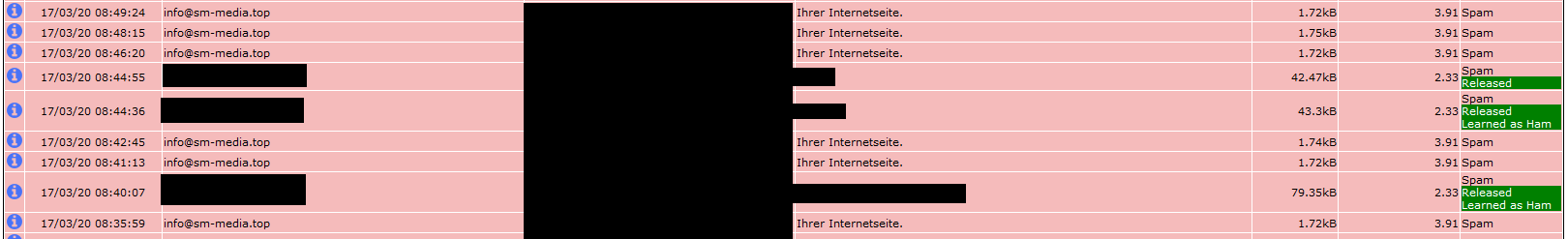

Hi guys,
I have a new problem.
I received some mails today from a sender I know - but it keeps being listed as Spam (light red).
When I click on the message and choose "Release" the mail gets marked as "Released" but I don't get it.
What have I done wrong or misconfigured?
Thank you very much für any replies.
Alex

Update:
I just changed the in back to 'false'. Now the mails will be delivered again but as an attachment.
If it is set tu 'true' there is no mail being delivered out of the quarantine...
I just changed the
define('QUARANTINE_USE_SENDMAIL', true);Code: Select all
/var/www/html/mailscanner/conf.phpIf it is set tu 'true' there is no mail being delivered out of the quarantine...

I just checked the logs and I could find the following:
It's working again
Had there been any changes in the last update regarding this?
So I checked Google and ran the both commands:Mar 20 08:17:47 mail postfix/smtp[58868]: 48kFV30P2wzC9J9: to=<<myname>@<ourdomain>.de>, relay=192.168.x.x[192.168.x.x]:25, delay=0.47, delays=0.44/0.03/0/0, dsn=5.6.7, status=bounced (SMTPUTF8 is required, but was not offered by host 192.168.x.x[192.168.x.x])
Mar 20 08:17:47 mail postfix/cleanup[57995]: 48kFV33gdTz4k18: message-id=<48kFV33gdTz4k18@<maildomain>>
sudo postconf smtputf8_enable=no
sudo postfix reloadHad there been any changes in the last update regarding this?
