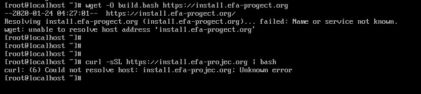

I thought about reinstalling again by capturing the installation process, however I couldn't because the domain appears to be inactive - see attachment.
- couldntresolve.png (27.32 KiB) Viewed 11792 times
Re: eFA4 - root pwd changed or?
You are spelling the domain wrong, which makes me wonder how you are spelling the password...

was simply a typo, I screwed up the wrong screenshot, the problem was on my router and I assure you it's not spelling issue.

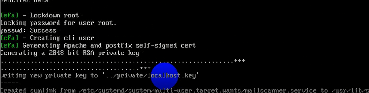

Attached it caught my attention during installation... idea?
- LockDownRoot.png (127.19 KiB) Viewed 11782 times
That is supposed to happen. Use your new cli user and use sudo.
