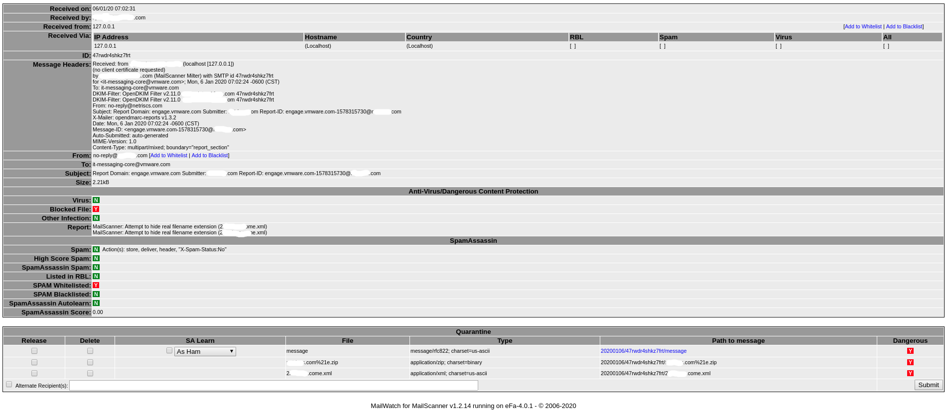

EFA MArks outbound DMARC as bad file
Post by netris »
I am having an issue all of a sudden where the DMARC emails being sent by EFA are being marked bad and that they have a bad file attachment. It was running just fine since the RC, but this started about a month ago....
