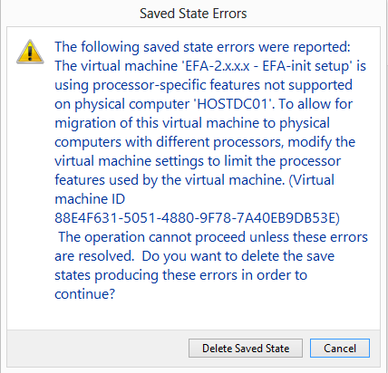

Note to self:
set processor compatibility checkbox for hyper-v
settings -> processor -> compatibility -> migrate to a physical computer with a different processor version.
In the current alpha you will get an error message when importing on an different CPU type then on my test host. (created on intel I7)
Virtual machine ........... is using processor-specific features not supported on host ........ To allow for migration of this virtual machine to a server with a different processor, modify the virtual machine settings to limit the processor features used by the virtual machine.
