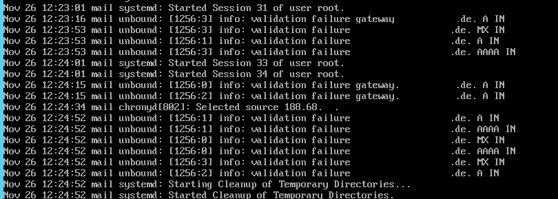

I checked the log directory and all I could find was this in "messages" file:
2019-11-26 14_24_41-Window.png (20.07 KiB) Viewed 10312 times

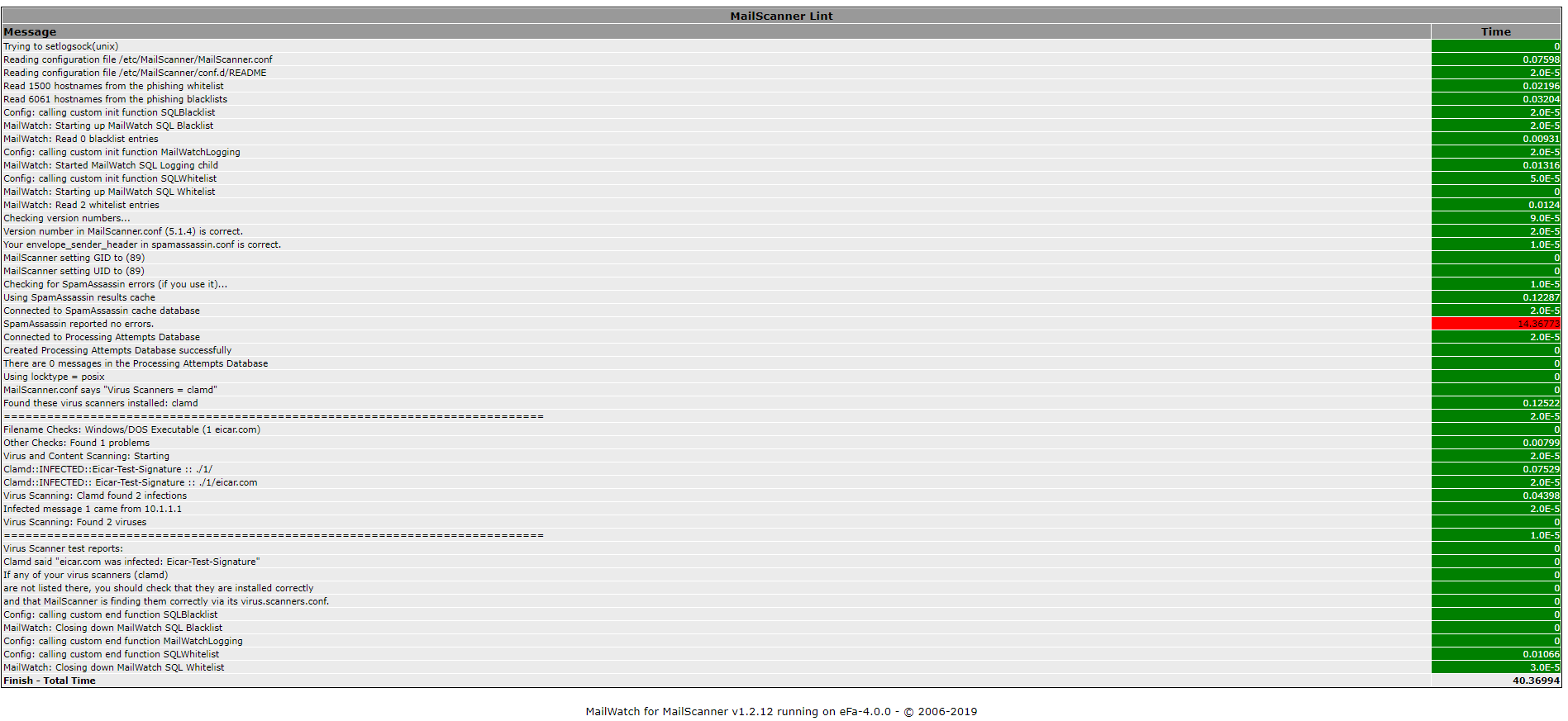

The Mail Scanner lint test in the GUI got me this:
2019-11-26 14_26_16-Window.png (69.59 KiB) Viewed 10312 times

Seems unbound has issues (DNS).
Can you
ping google.com
from within efa?
Check your IP and gateway settings ( compair it with the old efa).

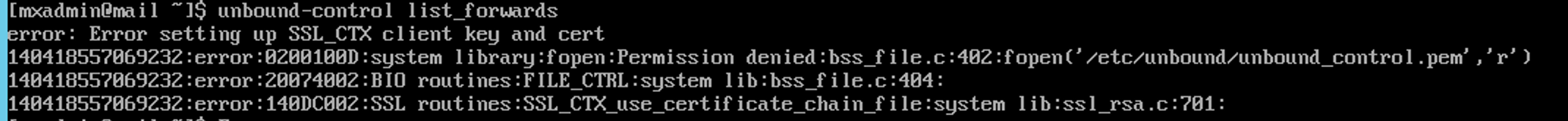

unbound-control list_forwards gives me:
Error setting up SSL_CTX client key and cert
Bildschirmfoto 2019-11-26 um 20.42.48.png (137.23 KiB) Viewed 10278 times

Looks like an selinux denial.
see anything in /var/log/audit/audit.log?
